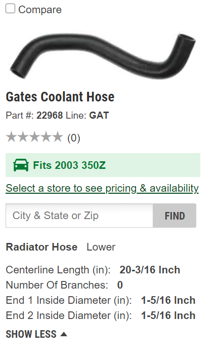

Just for complete book keeping. Since I found this thread looking for the same info.
It looks like 1-5/16inch
