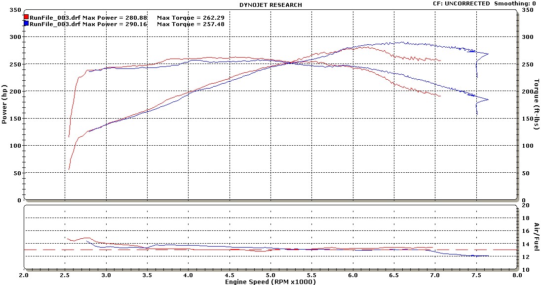

Here is a overlay of my 03 and a HR engine same day same dyno..
I had every bolt on but cams.. Was able to make more TQ then the HR engine. The HR had exhaust, race pipes and intakes.
My car ran a 13.005 and the HR was able to hit a 12.9 down the 1/4
Todd
Todd
I forget, but was your '03 tuned for the boltons? I'm guessing it probably was?...
Yeah, it was tuned with a UTEC..
Todd
