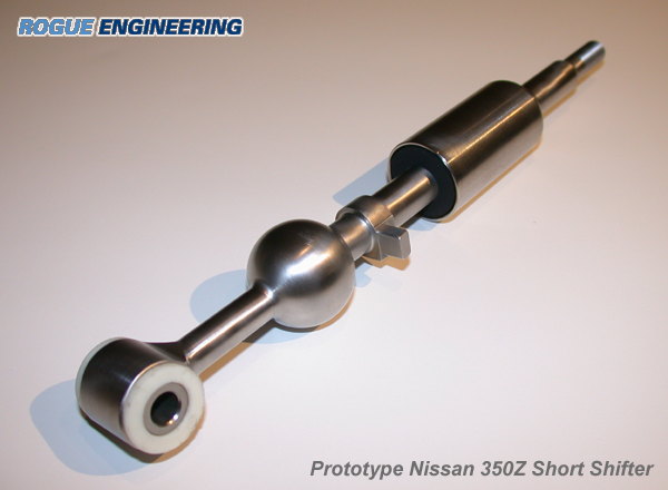

For the benefit of the many people that have asked in the recent past, we finally finished our 350Z short shifter prototype.
Not all was lost in the months that have past...we've actually made some changes to our original design concept based on feedback on the factory lever.
What you see here is a functional prototype, with the ability to isolate more vibration than even the factory lever. Like our current BMW shifters, our goal is to have short shifters to feel as smooth and isolate the transmission vibrations as much as possible. Whereas others may taut "racecar-like" shifting action, we feel that in most street driven applications that this is a negative aspect of a short shifter.
Currently, the production plans for the shifter is to be made from 303 Stainless Steel (upper and lower sections). The rubber insert used will be crutial in dampening vibration. Our evaluation of the factory lever shows that they actually use less dampening material than even our prototype. There are no plans to offer an aluminum or titanium shifter option.
As pictured, the shifter will include its own pivot bushings so the need to reuse the factory lever parts will not be necessary.
More information will be posted once we've sufficently tested the prototypes.
We do not yet have tenative pricing.
Many thanks for your patience and continuous inquiries. Comments and suggestions welcome and encouraged.

looks great, I'd love a shorter throw... how much shorter is the throw with this compared to stock?

Shift throw reduction is approximately 31-33%, depending on specific dimensions on the shifter. Again, in production it may vary slightly, but we'd like to see between 30-35%.

What if we want harder bushings for a more precise feel even if you don't think that is what we should have? Will you offer them or am I forced to keep the factory shifter so the feel is not dumbed down even more. I want it to feel as precise as possible not just short throw.

on occasion, we get asked for unique requests such as these. granted not often, but we do get asked.
simply, we could custom build you a shifter using much harder internal material. how much harder would be entirely up to you. we could give you some recommendations, based on your desired goals, but ultimately, it would be completely custom.

What sort of premium are we talking about for a "custom" shifter? I mean, bushings are available aftermarket to simply replace the stock ones for a harder feel. Why would you have to custom make an entire new shifter? Seems a little extreme to me...

Is there any sort of 'stop' that is going to be incorporated into this shifter? I could just see people shifting hard and bending shift forks or something like that that unless there are built in stops in the transmission?
My last car had stops built into the shifter, but the shifter also was bolted DIRECTLY to the transmission unlike the Z's/G.

Potato Head - Since we assembly all the current BMW shifters in house, it would not be any additional work to substitute a harder dampening material. When the production shifters are finally in stock, and you still want a "firmer" feeling shifter (you'd have to be specific), it would only take a few days to produce it. Wouldn't necessarily cost any more (probably the same), but you'd have to be patient.

expensive, is of course, completely subjective. we're not talking about the governement buying carbon fiber toilet seats expensive.
the factory shifter lever retails for around $100. Of course, their part starts as a casting, and then is machined.
Our part will be completely CNC'd from complete solid stock (round stock). Generally, CNC turning times are quick, but the CNC milling times take a while.
Add in some delrin bushings, steel sleeve, and modest production figures (100 - 200 pcs. quantity runs), and you still have an expensive part (if you mean more than $100).
