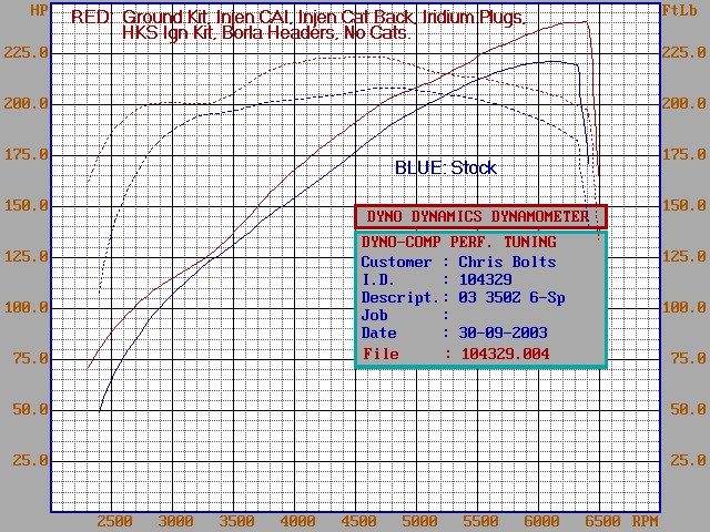

After I had the ignition installed, I also put my car on the dyno. Once again I didn't have a baseline dyno like at the previous dyno from Technodyne, but a stock dyno from another Z was used as a baseline. Now before you purists who scream and shout that I shouldn't use another person's dyno because the car's are different, shush. If you have a problem with this, then you can contact Richard Garcia, owner of Dynocomp and voice your concerns with him. Once again, I trust his assessment because he's been working in the auto industry for years, and recently quit the semiconductor industry to start his own business. With that said here is my graph. As you can see I gained over 20 hp/ 20 ft.lb. torque over stock. I don't have a dyno to show the gains after I installed the ignition, but overall I am happy with the gains of my car.

One question. Was the car used for baseline also have the injen CAI, Cat back, and the Borla header? From the graph, it looks like you have the CAI, Cat back and header. So if the baseline's car did not have all these mod, the spark plugs and ignition do not give much HP gain.
Old Oct 1, 2003 | 11:57 AM
Mr B's Avatar
Mr B
Posts: 1,654
From: Just another guy...
If you re-read the dyno, it tells you that he's got Borla headers, no cats, injen exhaust, and a grounding kit along with his ignition mods. I would think that the ignition mod gave him no more than 3hp but did help smooth out the powerband.

Considering that stock cars run from 210-250 base, how the hell is that dyno worth anything?
Yeh, i know you told us to stfu but seriously. Whats the point of the dyno again?

I believe this to be a fair comparison. I agree that the dynos are from different cars, which will vary some in performance. But all other variables are constant. These dynos were done on the same dynamometer, both done by Richard Garcia, I'm sure. Since he setup both cars, I'm sure they were both setup the same as far as ramp rate and other variables. Finally, the dyno corrects for atmospheric conditions (temp, pressure, ...). How much variability do you think there is among 350Z's measured on the same dyno, which has been setup exactly the same every time. I guarantee you it's not 40hp.

Well, dynos can be very misleading and we have proof of that with several posters who have used the Mustang Dyno. As Richard had explained to me, and no doubt some of you may already know, dynos test in several different ways and readouts can be different based upon the dyno used.
That said, don't pay attention to what I'm putting down. Several good things can be seen from the graph. For starters, I think this finally puts to rest that the ECU does not negate mods. As someone mentioned before, I don't think the ignition is giving that much hp, but it is something that is spread across the entire band.
Even if their was a 5 or 10 HP difference its not the best way to show gains for a mod.
Also was your car modded exaclty like the car you used for the baseline?

Actually it's cbsuper's car not mine. Also, I never claimed that what he posted was ideal, nor did he. His original post had a couple of disclaimers stating such. I just merely added that it's not as bad as it sounds. Most other variables have been accounted for.
As far as the mods go, the baseline one was bone stock. So, the results cb showed were for all of his mods, not just the ignition/plugs.
