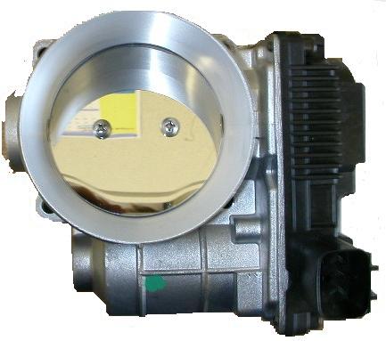

On a side note to this...........this was before the ECU was done.
As to what TechnoSquare found out......a stock ECU actually starts to close off the throttle at the top end. (for what reason I have no idea). A bored out and polished throttle body would have gains mostly just up top....if the TS theory is true (which I believe it is) then a bored out t Body would have little or no gains on a stock ECU. When we ran this throttle body we were running on a stock ECU.
Who knows what will happen on a reprogrammed ECU.

dwnshift
On a side note to this...........this was before the ECU was done. As to what TechnoSquare found out......a stock ECU actually starts to close off the throttle at the top end. (for what reason I have no idea). A bored out and polished throttle body would have gains mostly just up top....if the TS theory is true (which I believe it is) then a bored out t Body would have little or no gains on a stock ECU. When we ran this throttle body we were running on a stock ECU.
Was this an actual bored out throttle body with new plates or was it just a coned and polished TB? What size is the stock TB? So, if the throttle body starts to close up at full throttle near the top end then that explains why our power cuts out all of the sudden near the top. Did Technosquare solve this by allowing the throttle body to remain open? If so, I think I need this. I was going to wait and see what other people came out with as far as ECU tuning but I am getting sick of the fuel cut and other things such as this.

Yes TechnoSquare solved this issue. Tadashi is goooood!
We are selling bored out T Bodies just like the one pictured before. It is honed out and includes a new throttle plate.
The T body is $235+shipping (overnight) We will be doing a core charge with these. Basically you will need to send us your throttle body once you receive ours. If we dont receive yours..... then we will have to charge your CC the full amount for a T Body.
