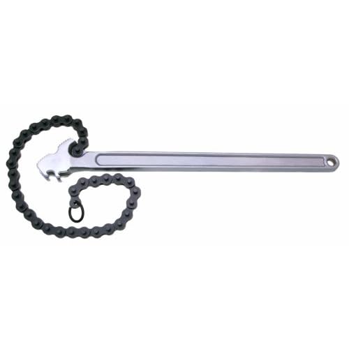

Chain wrench works best, just make sure you use a old accessory belt cut it so it wraps around the whole crank pulley that way you dont damage the pulley.
Here's a example of what you need.
