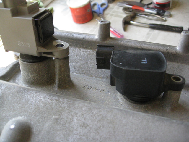

could the taller coilpack mount be milled down to other's specs???
Im sure the bolt mount will have to be drilled deeper and rethreaded, but its not that big of a deal.
As long as the o.d. of the base on the taller mount is the same as the shorter mounts, this should be the solution to the problem at hand
Good call! I'm going to order a set of these in and see what can be done. The seals are near the bottom so it seems that the machining will not affect the seal. We may need to locate or machine a washer of some type to seal off the upper lip area. Its seems a flange/ledge has been integrated to the top for PCV sealing.

They are installed now and I do have pics. The passenger side was the hardest and it is leaking because the gasket more than likely moved out of place when I put the cover on the cylinder head. It is really tight on the passenger side and I did not want to waste time taking more stuff off so I should have. There was also no way for me to see if the gasket moved because there's no room and I did not have a small mirror neither to check. They also clear if I remove the heat shield off the hood. The driver side cover does not clear the throttle body because of a hose tube but can still be used without problem.
More updates tomorrow.

The valve covers DO NOT work. The car misfires so I guess the coils do not reach far enough to the spark plugs with these covers. When I pull off the coils it doesn't seem that it reaches all the way down on the spark plugs. I don't get that pop sound.
Since there are too many issues with this mod it's not worth it. The hood does not clear the oil snorkel. The breather nipple on the driver side hardly clears the TB. None of the coils reach down far enough I guess without filling down the mounting surface and the coils also do not seal on the surface of the covers. I wasted 2 days on this and more time to come putting on the original covers and a lot of money for nothing.
I also found out that none of the spark seals were leaking on my car even at 100k miles now(could be because I used Mobil 1 with Lucas synthetic oil stabilizer $60 per oil change). But somehow the motor had oil in the lower and upper plenum.
