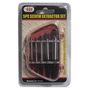

Old May 26, 2010 | 07:52 PM
Brett@AwesomeZ's Avatar
Brett@AwesomeZ
Vendor - Former Vendor
Joined: Oct 2009
Posts: 400
From: Houston, TX
Originally Posted by zaperroni
Those things are really the last ditch effort only in front of drilling the bolt/stud out, a lot of times they just don't work, or break if you get the cheap ones.
Vice grips are the way to go here after you get the rest of the upper intake off, if you still can't get it, grind flat spots on the side of the stud so the grips don't slip.
6ft/lbs are the most that hardware should see.
