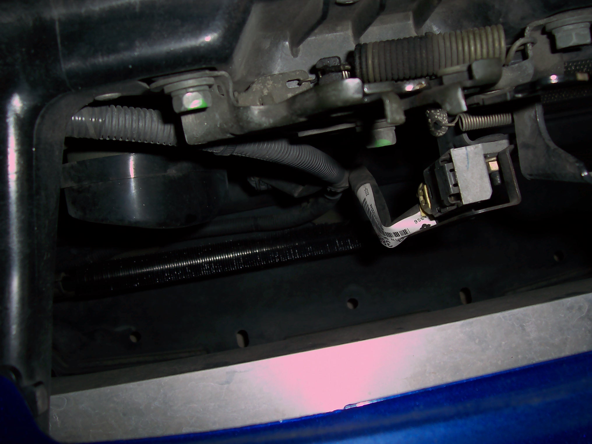

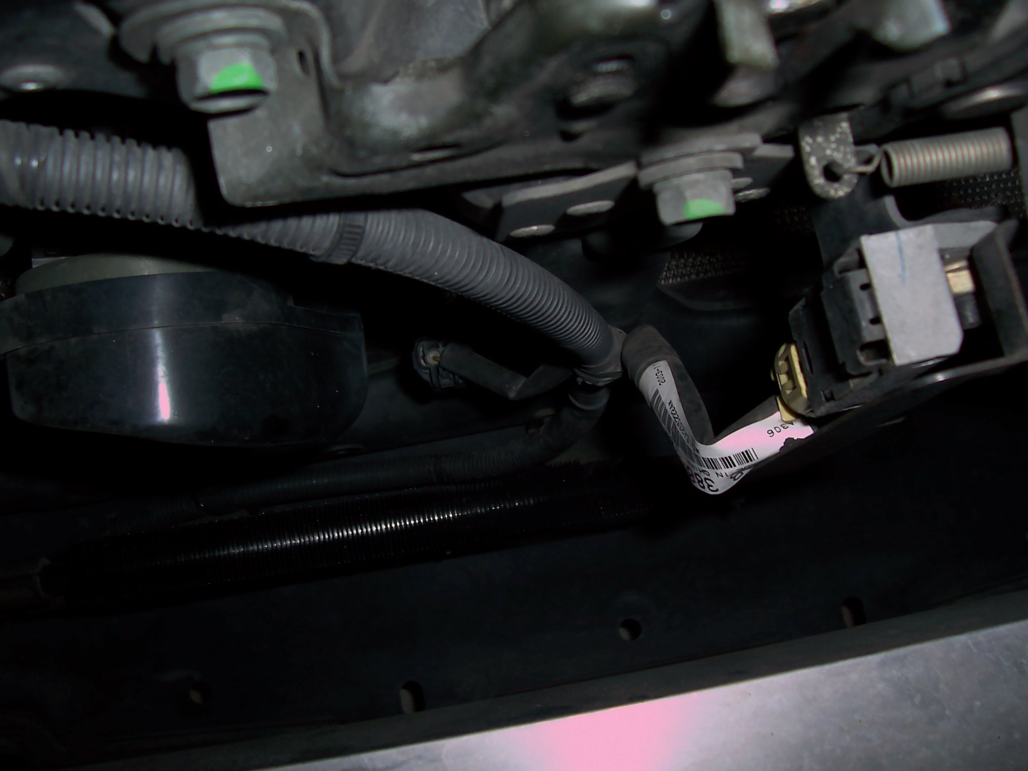

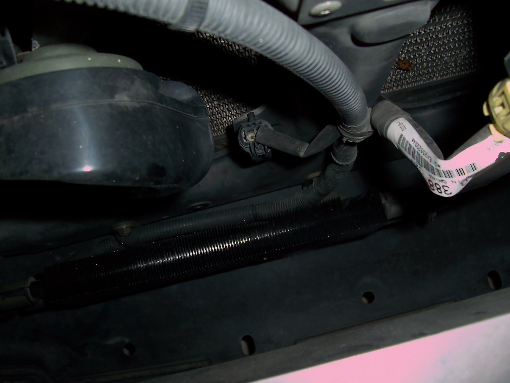

The ambient sensor should be down below that one.
See if you can follow in these three attachments. The ambient shows up between the horn on the left and the crash sensor on the right.
Attached Thumbnails Installed oil cooler, now outside ambient air temp reading incorrectly-100_0572.jpg   Installed oil cooler, now outside ambient air temp reading incorrectly-100_0573.jpg   Installed oil cooler, now outside ambient air temp reading incorrectly-100_0574.jpg

Dave, must be this sensor with my blue arrow pointing to it?
Again..thanks for taking the time to help me.
Old Sep 13, 2010 | 02:46 PM
DavesZ#3's Avatar
DavesZ#3
iTrader: (26)
Posts: 15,887
Likes: 23
From: Louisiana
Yes, that's it.
