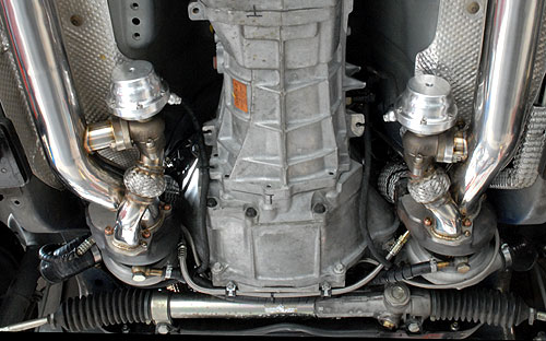

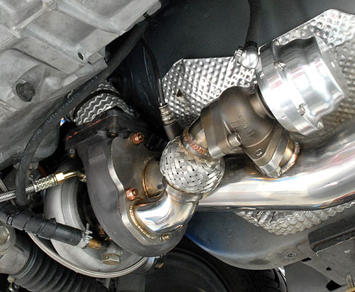

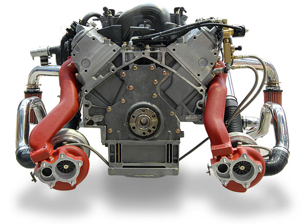

I wish someone had this kit locally i would test it right now if it fits

Old Feb 18, 2012 | 01:39 PM
  #212
bbs350z's Avatar
bbs350z
iTrader: (85)
Posts: 6,662
From: Scottsdale AZ
if this works, then we would literally have a bolt on turbo kit for swapped z's lmao. i am impressed

that twin turbo kit will have to be adjusted greatly for our engine bay. Those things are way wider than we have for room.
Old Feb 21, 2012 | 12:25 PM
  #217
bbs350z's Avatar
bbs350z
iTrader: (85)
Posts: 6,662
From: Scottsdale AZ
i have tons of room from my sikky headers to my frame. the only tight portion is near the steering shaft. the aps manifolds seem to hug the block alot closer too. the only part thats iffy, as stated above was the intercooler piping, but we have sasha for that
