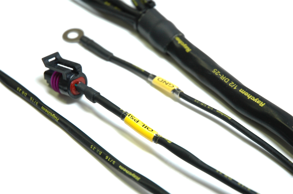

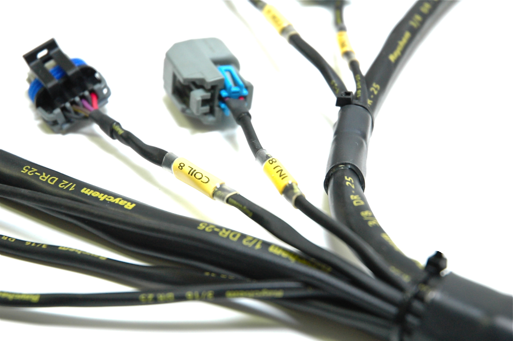

EEEEEK at that wiring harness!!!!! The idea of relocating the coil pack its a good idea but looks like you will run into clearance problems when you turbo it.
My wiring harness = no tape and lots of RAYCHEM DR25

also included is a version with out raychem and loomed in nylon sleeving

Other than the 3 chassis plugs that we reuse from the Z/G harness everything is completely brand new. Those 3 plugs even get new terminals. So you are getting all new wire, terminals plugs, wire and loom. No solder or electrical tape is used with our harnesses. Only adhesive heat shrink, nylon braided wire loom and or rachem dr-25 nothing cheap or half assed. My wiring harness took less than 2 weeks to complete.
