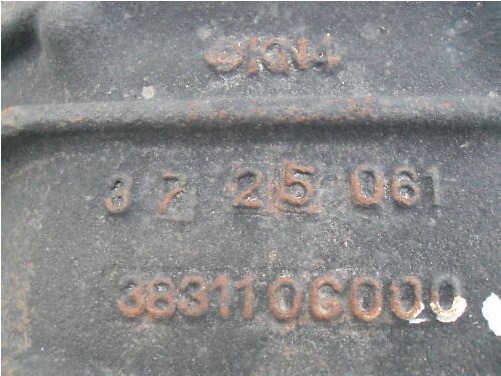

Its for an 03-05 6MT. Is the 3.5 the only ratio they come with other than NISMO?

FOund this on another site- WOuld this mean its a 3.5?
the 38311 is the gear ratio, should be 38 tooth ring gear and 11 tooth pinion for a 3.46:1 ratio

check if its written/painted GC GB or GD on it

That should be the 3.5
Exactly - all 6MT had the 3.5, but GD is a VLSD and GC is open. Not sure what GB is.
