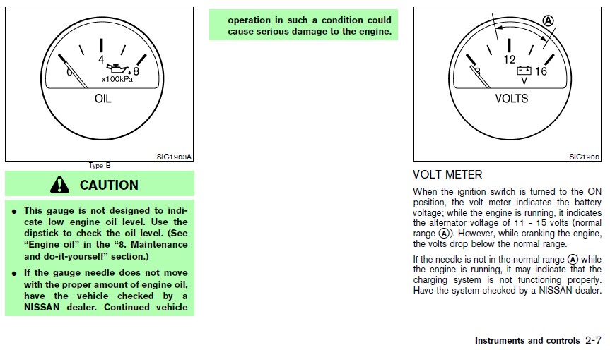

I know thats a really basic question, but I have no idea why I have those gauges. They werent in any other car I've driven. The volt meter has something to do with the alternator I think, but it always goes to the same value.
The oil pressure needle changes as the car warms up from like 60 to 20. I still dont know what either of those mean.
are you supposed to look at these gauges when you're racing or something?

Click the thumbnails below for what's in the owner's manual.
Attached Thumbnails what do the oil pressure and 'volts' gauges tell you?-screenhunter_01-apr.-22-18.06.jpg   what do the oil pressure and 'volts' gauges tell you?-screenhunter_02-apr.-22-18.06.jpg

Originally Posted by ou8thisSN
yeah i read the manual, it didnt really give a lot of insight. sorry i know it is a newb question, just thought i'd ask since you guys have helped me learn so much already. thanks anyway
All of us are extremely sarcastic at heart. I've been there too. Before I had my Z, I knew NOTHING about cars.
In general for gauges in most vehicles, the middle is "normal" just to make it easy on the average user.
Your oil pressure gauge will likely be around 40-60 at idle (middle) and will be higher when on the throttle and accelerating. The key is to make sure that you don't notice the pressure staying low. It's mainly there to let you know that you have enough oil in the car and that it's circulating properly. This is because without it, stuff is gonna get hot, and then break.
Your voltage gauge is going to be above 12V when things are fine. Probably around 14V most of the time when the car is running. 12V minimum is what everything expects to run off of in a car, so you want it to be above that or electrical systems aren't going to work. When your car is running, it shows higher than 12V because the alternator puts out a higher voltage in order to charge the battery.
the battery needle is exactly where you describe it to be. when the car is warmed up, the oil pressure needle is just under the hash mark between 0 and 60, (so around 30). It does get higher as i accelerate. I havent noticed any oil leaks in the garage under the car chassis, so I can assume thats as good as being at 40?
also, thanks for explaining it. im slowly but surely learning a lot from being here
No biggie. Some nights I'm in a helpful mood, sometimes my sarcasm font is on and I like making people work for it. You picked the right night.
Your oil may be a little low or your gauge may just read a little lower than mine, so it's worth checking the dipstick. Instructions are in the Owner's Manual that I posted earlier.
If you're a little low according to the dipstick, go ahead and get an oil change instead of just adding some more oil. This is since you're just now figuring out where your gauge is going to read when you're at the right level. Once you've had your oil change, see if the guage is reading a little higher and more in the 40-60 range. Regardless, the level right after your oil change is going to be your "good" range at idle. After that, you just keep an eye on it in case it gets lower (if your car burns oil or something bad happens).
