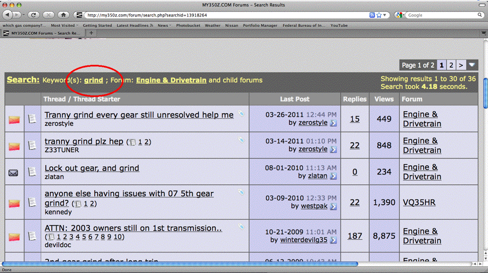

The 350Z transmission is problem free. Except these 36.
