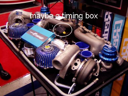

I don't know if you know this but the other little electronic box ( its black approx 3"X3") that comes with the turbo kit is that a timing controller because they could not get the e manage to work?
spazpilot: I was not aware that there is going to be any timing controller at all. If this is true, I would still need something adjustable based on boost pressure and preferable another scale such as boost/rpm using an independant MAP sensor. Then I could simply datalog what a stock 350z is doing and make changes based on what boost at what RPM.

the black box, according to our instruction book, is a interface for the E Manage to get an RPM singal...part #64.
