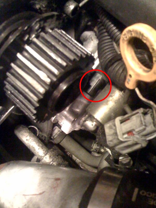

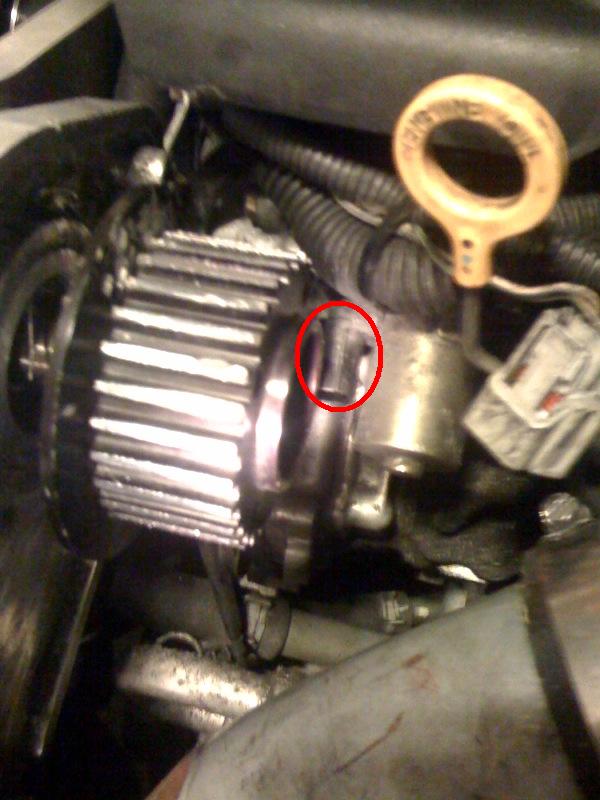

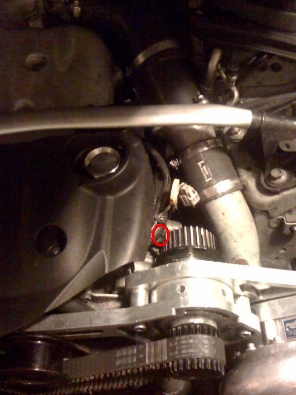

Replacing pulley due to wear, however It simply wont slide out due to some **** being in the way
Took some pics, it seems to need 2 more cm to slide out, however that black piece wont move and is blocking the pulley from coming out.. Any help/suggestions/ideas?

can you unbolt the supercharger ?

+1...you will need to unbolt, or at the very least loosen the the bolts that mount the blower to the mounting plate; that should give you the 2cm you need to pull the pulley out...

Thanks for the help but I really didnt wanna remove the whole s/c since both the main and blower brackets would of had to been removed (..meaning everything)
for future in case anyone stumbles upon this: turns out the piece which was in the way is the IVT control valve and its held together by a 10 mm bolt, when bolt is removed it swivels around and moves enough out of the way for pulley to easily come out
