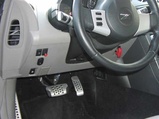

My switches (bottle warmer, remote opener, guages, and nitrous activiation switch) are all togehter on a single unit :
http://dynotune.org/store/Scripts/pr...p?idproduct=88
It may be ugly, but it works. I attached a connecter so I can detach this switch. The dealer will see the empty connector.
The stealth install is so when I do to the dealer for maintenance, i.e. brake warranty fix, to get TSB/TSA's fixed, etc... they usually don't go snooping around for other things if I am there for something specific. Unless they really look and tear some things up, they won't be able to easily see my nitrous kit. Even the bottle is hidden. I leave the bottle in when I go to the dealer ship for TSB/TSA's. No problems yet and I am there everytime a new TSA is released.
If I were to blow something, I would obviously remove the kit and the I mounted everything will leave no traces. I didn't even mount the bottle brackets to the chassis (no drilling), I didn't run the nitrous lines outside the car, which means i didn't have to drill a whole to get the lines outside the car, I didn't even screw the Zex unit into the sheet metal as well. I made no permanent alterations to the car.

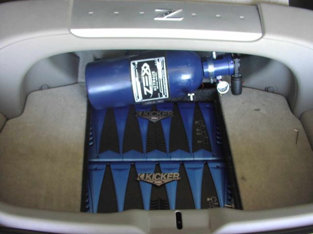

Bracket welded in suspension

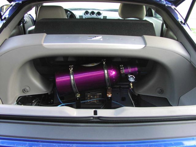

final look, fug the dealers.

*protected* arming switch.
