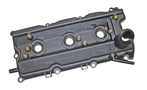

PCV valve
typical hose:
Large bung on back of driver side valve cover:
see the vaccum lines going through the metal bracket:
