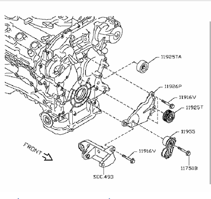

try this diagram
http://www.courtesyparts.com/350z-pa...5_716_722.html

Originally Posted by travlee
Thanks for that. Not sure why I can't bring the illustrations up...
But by looking at these pictures the bolt I need isn't there. It's the super long one that adjusts the tension on the belt. The only ones I'm seeing here are the bolts that attach the the pulleys to the bracket and so on.
I looked at it lol!
Where is the bolt for the tensioner though Trav?
All the bolts there are for mounting everything. The actual tension bolt isn't there though. Which leads me to believe you have to purchase the tensioner to get the bolt...
The bolt I'm referring to doesn't mount horizontally. It's goes in vertically.

oh, i thought you said you couldnt see it... my mistake
so like #6 here?
http://shop.gwinnettplacenissan.com/...sembly=5996260

i bet you have to buy the whole assembly
http://www.ebay.com/itm/350Z-AC-IDLER-PULLEY-OEM-NISSAN-2003-2006/251988032561?_trksid=p2141725.c100338.m3726&_trkparms=aid%3D222007%26algo%3DSIC.MBE%26ao%3D1%26asc%3D20141212152715%26meid%3Da4b294c5affb4cf0b652d102e781952f%26pid%3D100338%26rk%3D1%26rkt%3D26%26sd%3D271953647881
