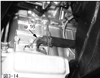

I have a low mount turbo setup. The HKS kit i had used 16mm ID hose from turbo drain to the HKS oil pan shown here

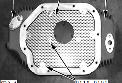

HKS
Pros: Baffle mesh plate, cooling fins
Cons: It has no internal director plates like the KLS does and no oil pick up spacer, uses hose fitting instead of AN fitting.
I will be selling my HKS kit and therefore need to buy another pan or spacer for myself.

I have no oem oil baffle plate btw like this

Can't you change the HKS hose fitting to AN? I would keep the HKS.
Also, the oil return line is low pressure. Not much need for AN anyhow, other than cosmetic.
