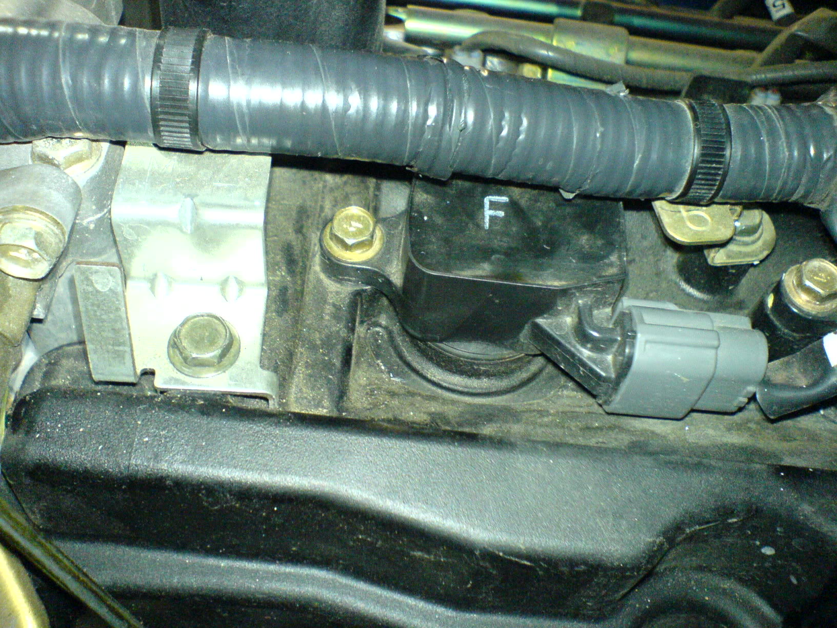

each cylinder has its own coil pack, from the top it looks like this
and when removed it looks like this

being the car is 13 years old, the plastic is probably becoming brittle.
i wouldnt rev the car when it is cold
