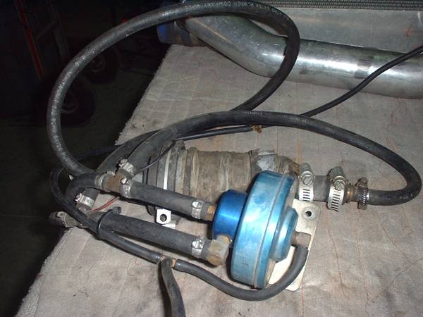

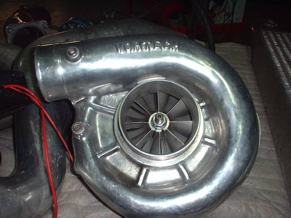

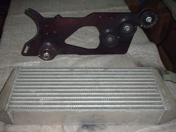

I found this for sale in a local garage. The ECU says 350z. Can anyone help me identify if this will fit on my 2004 350Z? Any information will help. The owner claims to know nothing about it.

Appears to be the non rev-up kit, it should fit.

That is definitely the bracket for a non-revup engine, so it will fit your 04. Make sure all of the spacers needed for the kit are included because they are very expensive and only available through vortech.
That head unit appears to be a v2 from the picture. If you are unsure, just turn it over and see if there are 2 threaded holes in the side (one for oil feed and the other for oil return)
Use this install manual here to make sure all pieces are there
http://www.vortechsuperchargers.com/images/50.pdf
