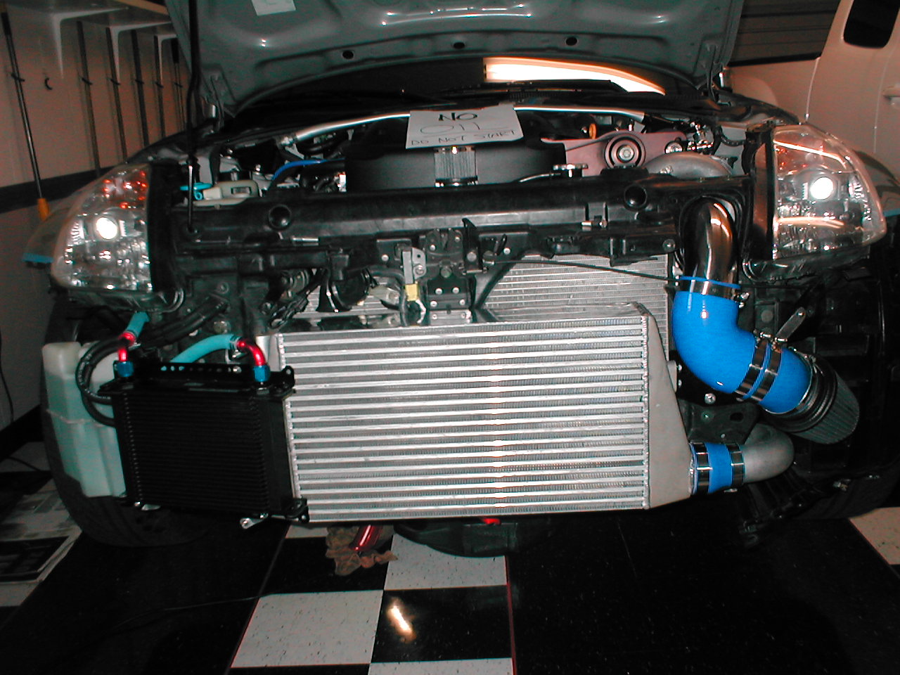

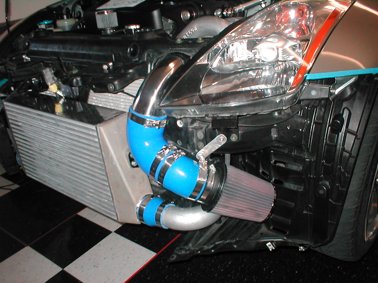

Your are Robbing your Motor of Horse Power By necking down the Intake Pipe to a 3" Tube.
Old Jun 6, 2016 | 04:12 PM
Boardmaster84's Avatar
Boardmaster84
Joined: Apr 2015
Posts: 28
From: Greenville, SC
What do you suggest then? i Couldn't get a 3.5 to fit correctly, would i be better off with the stock filter?
Old Jun 6, 2016 | 04:25 PM
OldManZ350's Avatar
OldManZ350
Posts: 2,429
Likes: 230
This is what I did. You do have to open up tht pass thru hole a little though.
