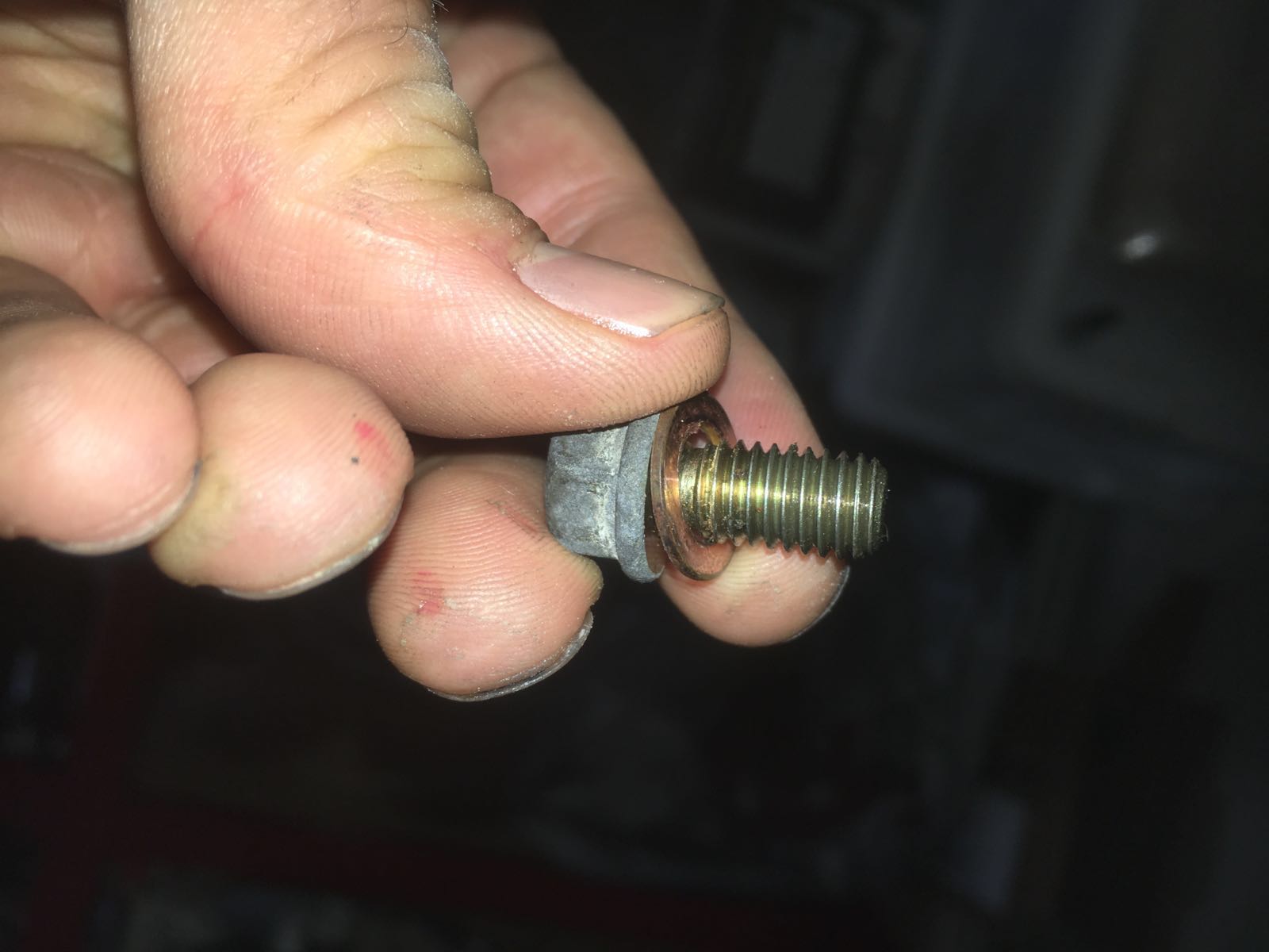

So the leakage seems to come from one of the holes shown in picture, and the bolt im missing, which is on its own (instead of actually bolting in anything) is missing. Didnt find it anywhere.
Anyone happen to know the size of this?

Put the smallest open end wrench that fits on the thread. It's metric and course thread, mb 1.0 pitch. That will get you close, gl.

The FSM will show you where the block coolant drain plugs are. Nissan also says to use thread sealant/rtv depending on the coolant drain plugs.
