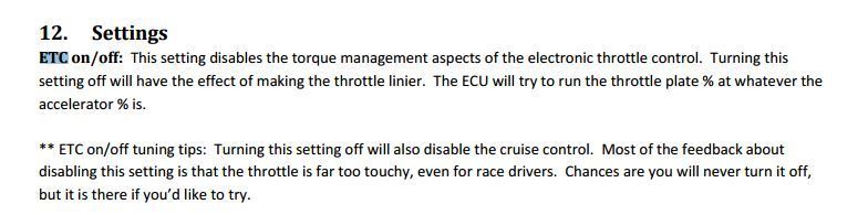

That is very weird that with ETC on it acts up.... Have you monitored the throttle pedal voltage output in rom editor? Should be ~.75-~5v
Two things just for peace of mind, you did the TB learn and idle relearn, right? and also are all of your grounds hooked up and in good order?

Yeah - so with ETC on, UPREV shows basically my pedal (V-ACCEL) putting out .5 volts at idle and maxing at 2.22v when to the floor - the throttle sits at .7 at idle then .78 when to the floor. So it is not correct.
With ETC off - I get .75 to 5 like it is supposed to. And the throttle responds as such.
I've swapped throttle bodies to two separate new ones - same results. Pinout with multimeter shows the same.
Yes I did all the corresponding relearns - manually and automatically. I origionally suspected a short in the harness and was going to patch a bridge to the throttle from the main connector - but since it works with ETC off, I figured all was well connectivity wise.
Let me know if that does anything, maybe start with the ETC on, give it a go, then try the ABS plug next so if you get lucky you know what did it.
So what exactly does ETC in uprev do then? hmm.
If it disables cruise control.... It could definitely play a role in your problem.
Though they don't mention to keep it on with AT vehicles, but hey.
Is your throttle map AFU? Or is it unmolested?

Hmmmm. The cruise control may be the culprit? ABS kills cruise, ST/Angle kill cruise, Slip/TCS kills cruise.... Or at least it is all tied together with my issues.
Throttle map is using the generic UPREV Tuned preset - switched it to OEM - but nothing changed.

Ah! The consult II instruction video.
Okie dokie. No change.
ETC on, ABS connected = Stay in first, shitty throttle.
ETC on, ABS disconnected = stay in first, shitty throttle.
ETC off, ABS connected = stay in first, great throttle response
ETC off, ABS disconnected = stay in first, great throttle response
Tried transmission in manual with all 4, no change. Got up some speed and hard brake when the ABS was on to see if I can knock something right (step 4 of the LS swap handbook) and nothing changed.
Disconnected ICC with each step. No change.
With all of the above, never once tripped an AT code. Maybe my AT works good and everything else is just crappy??? Lol.
Back to square one.
