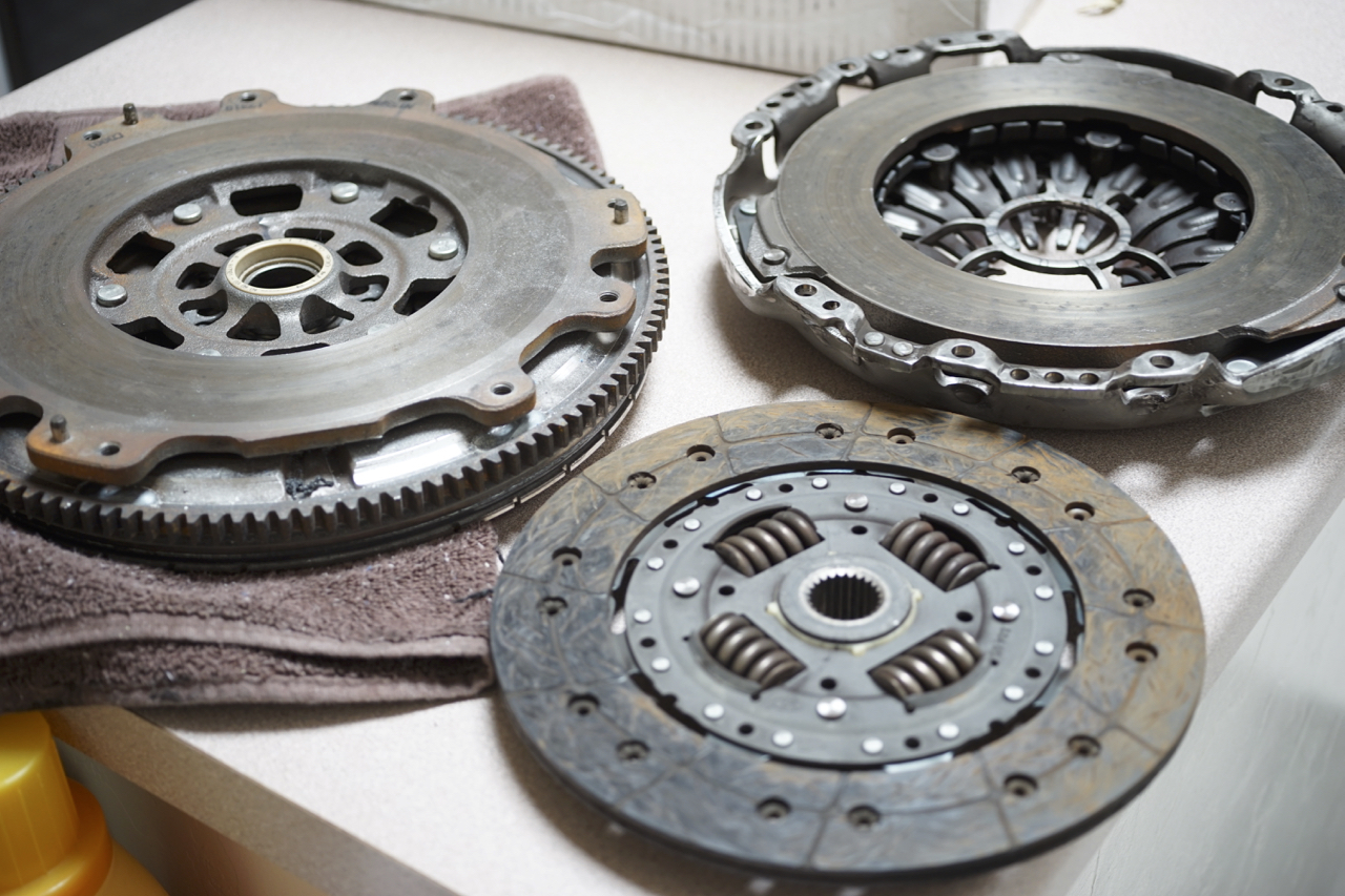

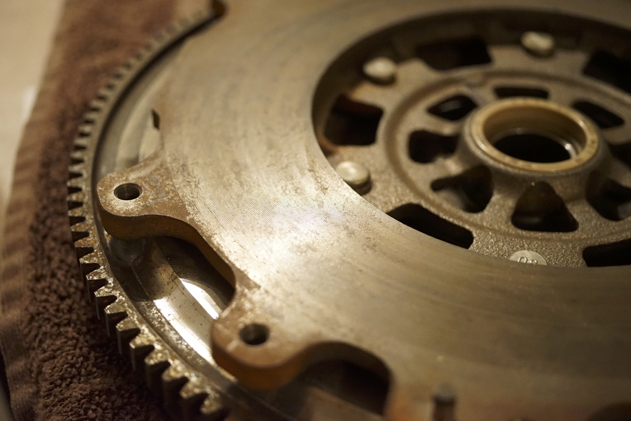

The clutch I bought off the seller (a Nissan executive that was on these boards before swapping cars) shows rust colored patina in the teeth on the side and on the face plate area...any cause for concern? I didn't know what I was doing when I bought it, still don't to the degree that I would like. I'll attach a few pics.

The pic of three items in pic is what I have for the clutch...my understanding is I just need the throw out bearing and then I have an entirely new clutch?

clutch should be fine, just clean it well with brakleen. I would replace the pilot bushing(like$5), and do the slave/master. do it right and it will be fine for another 100k. sleeve is reusable. if its the thin sheet metal clutch fork, replace it with the newer cast fork and smaller pivot ball.
