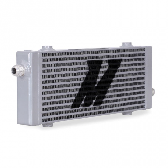

Just like some others on this board I am looking to do my own oil cooler set up but running into issues with room behind the bumper. Came across this bar and plate oill cooler from mishimoto but no one seems to have any info on it. Has anyone seen or heard about people running this type of oil cooler? Looking to see if people saw any benefits or experienced significant pressure loss?

The cooler that I asked about is a Mishimoto one. I haven't heard any horror strories about their coolers in general, however this is a different type of cooler then what earl's or setrab use.
I seen them use it on a mustangs and focus RS but have yet to see it used in other applications.
The set up that i am doing is having a thermostatic sandwich plate with 10AN stainless steel braided lines (aeroquip lines/fittings). I wanted to put it into the grill opening as i have a large transmission cooler for 5at going in the lower left and steering on lower right.
Hence i was asking if anyone heard about the bar and plate type coolers?
Whats acceptable pressure loss to have with an oil cooler set up?

It does sound like you are tight on space. -10 AN is what I use without issue.
Never used this one specifically, but there are many specifics re: the internal architecture of coolers aside from just "bar and plate vs plate tube and fin," that a specific comparison of both becomes as it relates to pressure drop becomes largely academic. Not to mention the relationship of cooler sizing is very important also.
Furthermore the likelihood that someone who used this core specifically would have meaningful pressure drop data is extremely small. Not just "my dash pressure gauge reads the same" kind of data obviously. If someone did, it would be pretty cool obviously.
I bet if you reached out to the manufactures they will be helpful.

I've always used the bar and plate type coolers, and cars I've had that came with OEM coolers also had that type. I'm under the impression they have more surface area and better heat transfer than the tube and fin type. I can speak from experience with regard to a/c condensors, which are obviously also heat exchangers. My old BMW 635 had an original tube and fin condensor, and very poor a/c performance. The big upgrade for these systems is to swap for a parallel-flow (bar and plate) condensor, and it makes the a/c actually usable.

I like setrab for sure, if you dont mind a used one they are $20 - $100 all day long on ebay. I also like PWD and C&R ... but I'm preferential to NASCAR stuff.
AN10 lines seem large...larger line means slower flow, means more time in the cooler...it could be beneficial. I run 1/2" lines so were both in the ballpark.
I wouldnt worry about pressure drop on a single . I run two (albeit) smaller coolers and my oil pressure (measured at the OEM location, after ~6 feet of AN4 to a secondary filter, and at my turbos) are well within specification - I lose 5-10psi from the pump to the blowers.
Surface area is important (I'm not saying it's not) but passive airflow to promote heat transfer should be the priority...If a 300 sq*inch cooler is stuck in a 150* engine bay it's performance will be far less than a 100 sq*inch cooler thats in passive airflow.
OP, you'll get much better performance if this cooler has passive airflow to AND from the cooler.

^Good info. 1/2" puts you at 8AN, so at least were ballpark. -10 is 5/8," which could make a difference in this application.
To add to bealljk's point, actually the main difference between a bar and plate cooler and your standard Setrab style (stacked plate and fin), internal architecture aside, is how air flow across the front of it.

GUITMAN32 - I tried reaching out to Mishimoto for help/info about their testing, but they were not helpful at all as they had no data to share. I did find some info on the same cooler being used on a mustangs and focus RS and apparently the guys on forums who did their own testing reported a 5-7psi drop. I dont know if their oil system is that much different than ours or even if thats a significant drop to be concerned about.
DCAINS - supposedly bar and plate does have better cooling property then tube and fin. At least from what i read up to now. Thats why i raised the question on here to see if anyone else had same mind set as me.
BEALLJK - Reason why i went with -10AN lines was due to other kits on the market having the same line sizes (mishimoto, stillen and z1) Whats acceptable pressure drop for our cars?
Since i have a G35, i am planing to put the cooler directly into the front grill. WHich should give me sufficient air flow for the cooler. Draw back to the bar and plate unit is that due to its beefier design it tends to block some air flow for condencer and radiator. I hope my Koyo will be up to the task to cope with cooling the car down. Maybe ill switch to 70/30 or 60/40 mixture.
