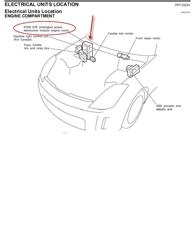

Sounds like you IPDM may have gotten a little wet. Check it.

I never thought of the IPDM. Moisture in the IPDM can cause a simulated limp mode?

Yes. If it gets wet it can cause an array of electrical miscommunications.
