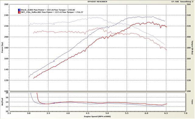

*Edit - You're not dyno'g with the stock wheels??? Dude, you're adding in variables. Wheels/tires on a dyno ... KEEP THEM THE SAME.
Agreed. Here's a dyno overlay of a stock touring Z vs. a stock enthusiast (just JWT intake) with 19" volk gt-c's.
Same day, same dyno ... but different cars.
Not a great example, but considering all the variables of a dyno, different wheels do make a difference.
what tires was the Enthusiest running???
Switching your car to tank tracks wouldn't rob this much power. There's no way of knowing how much of this difference is due to the volks/tires. I don't buy the wheel thing either, droideka lost too much power for that. Maybe it's the dyno, but it's definitely a red flag.
