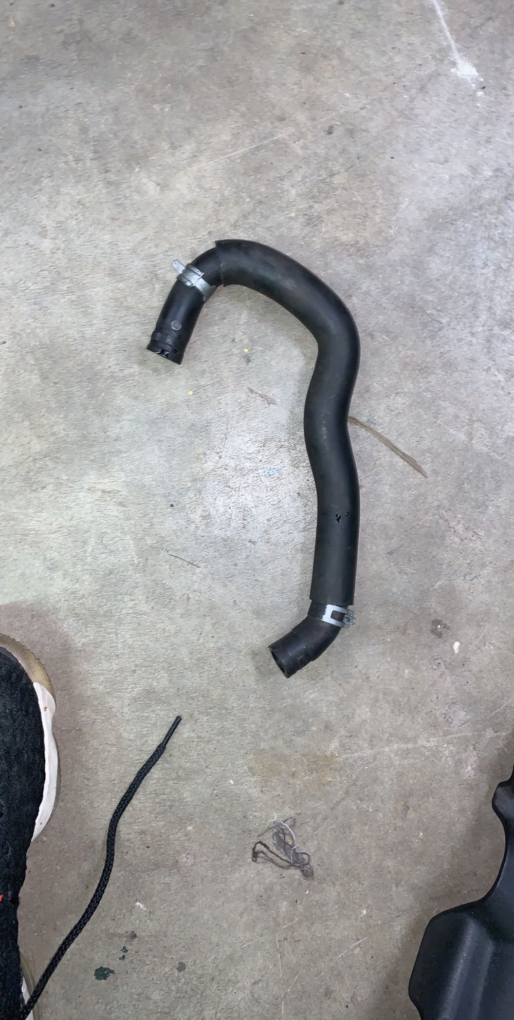

Before the hate rolls in , im just an average 18 year old trying to stop his z from misfiring , long story short got both valve covers replaced , everything went smooth, nothing broke, everything went back together PERFECT , so i finish putting my throttle body on and i turn around to grab my intake and bam, there it sits (see picture) my heart kinda dropped for a couple reasons , i didnt know where it went , i didnt remember where it came from , i didnt even remember taking it off ...
I know 1 end goes to the DRIVERS side back of the valve cover , But FOR THE LIFE OF ME , ive been at this 2 f’ing hours and CANNOT find where the other end goes... Im tired,
my head hurts , this car has kicked my *** today.
Please as dumb as it may sound help me lmfao...
WHERE DOES THE OTHER END GO!

A hose goes from the Driver side valve cover to the actual intake tube.

If its not the vent hose is it the hose that goes from the passenger side top plenum to the hardline brake booster hose.

Back of valve cover to intake tube (underneath)
