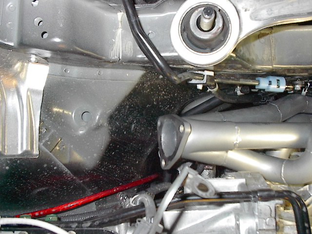

Peptidbond & I have installed the Crawford Headers & Hi-Flow Cats today. I must say that it has been a chore, enjoyable none the less.

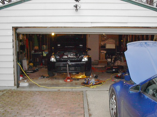

buff you can lift the z up in that position from there?...using that specific jack? can you show a close up of where to put it please?

The backend of the car is on Ramps & the front is sitting on Jackstands, I think the setting is 4 or 5. The first picture is from when we lifted the motor to remove the motor mounts & rock the headers into place.
We started Saturday afternoon (11-11:30) and wrapped up last night around 11:30. We had two brakes for food & 1 trip to Sears. So we're looking at @ 9 hrs for the install. We will be doing some "clean up" work today, after a trip to Summit Racing & to the Home Depot.

As for the install with jack stands, it was tough at times but okay. We had to drop the steering rack (not removed, just lowered) and that caused a little under car clearance issue. However, one of us worked from the top and one from the bottom. It was a good system.
As for jack placement, as Buff mentioned, the jack in the picture is holding up the engine. However, you can jack the car in the middle like that. Your placement is to put the jack head on the engine support cross-member.
