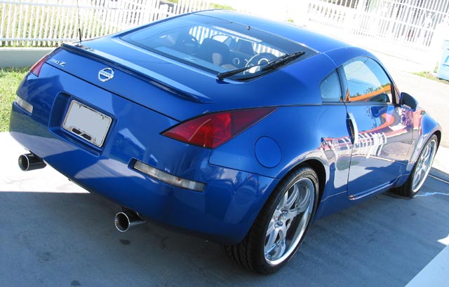

I love the sound of the Stillen. Borla and Nismo sound a little loud to my taste. The Stillen sound at idle a only a little loud than the OEM but rumble at full throttle with a noticeable power gain.
This is a link with a Stillen sound mpeg
http://www.zfilms.org/SportZMag/Dyn...lenExhaust.mpeg
Borla sound mpeg
http://www.zfilms.org/SportZMag/Dyno...laExhaust.mpeg

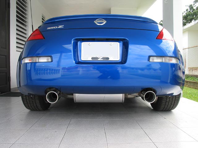

More recent picture

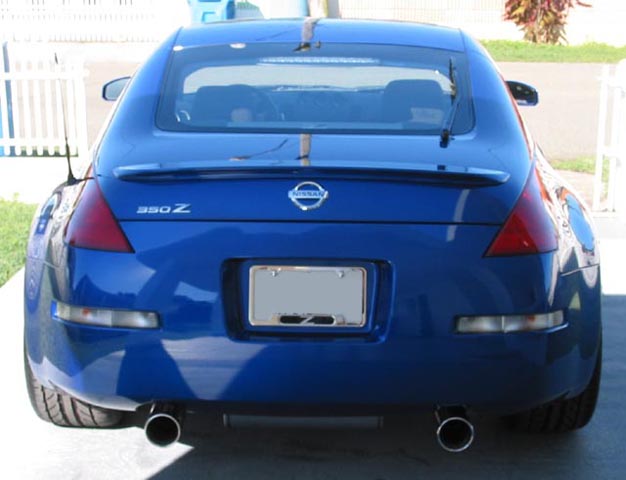

Another picture
