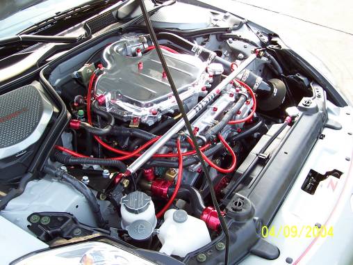

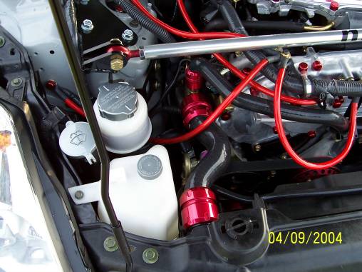

Thought I'd post a few pics of my new re-vamped engine bay: Crawford polished plenum, Crawford strut support, black Samco hoses & Pi-thon compression clamps, CF air finisher (painted by ZPRESENCE on 350frenzy.com) & cut engine cover for Crawford plenum (also painted by ZPRESENCE).
About the Samco hoses & Pi-thon clamp combination: due to the thicker walls of the Sanco hoses (making their O.D. larger), I would recommend either doing the Samco hoses with stock clamps or the Pi-thon clamps with the stock hoses - the hoses were a b**ch to get in the clamps and a BIGGER b**ch to then get over the fittings - took over 4 hours for 3 water hoses - yikes!! If I was doing it again I'd go with the Pi-thon clamps on the stock hoses, for sure!!
Anyway, a few pics....1st, a couple Pi-thons and a Samco......

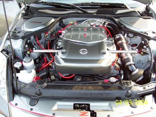

From: Wichita, KS
Default Bay......
with cut engine cover........

From: Wichita, KS
Default Bay....
without cover..........

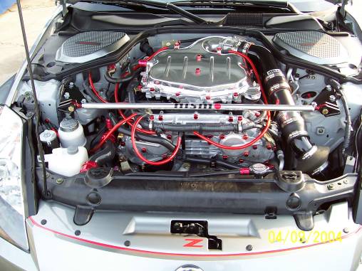

From: Wichita, KS
Default Bay again.....
without cover...........

Default Re: Bay......
Where or how did you get that engine cover cut?
Looking to do the same thing......
Old Apr 10, 2004 | 06:19 PM
Z CRUZN's Avatar
Z CRUZN
Posts: 675
From: Wichita, KS
Default How to cut.........
Cut the engine cover on a bandsaw & finished with my Dremel. Held the cover on an uninstalled Crawford plenum, drew a line on the under side of the cover around the plenum, backed off 1" from the line and started cutting. Did a bit at a time, re-checked, cut a little more, etc. until it fit. Then installed the plenum & strut support, set the cover on the strut bar to see where to cut the sides of the cover for the bar to fit under. Did it again a little at a time until it fit. After fitting, filled in the back of the cover where the remaining "V6" & "3.5" were with epoxy so my paint-guy could shave off V6 & 3.5 & paint.
