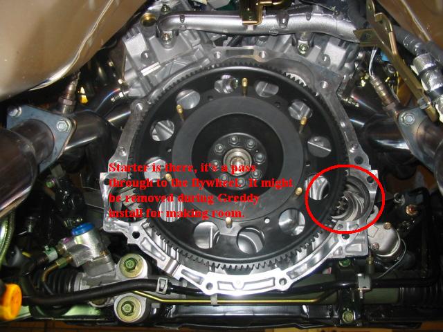

I think I have found a good spot for you. Thanks to Jeff at Performance, I hope he doesn't mind me stealing his pic.

I have to agree with UsafaRice. The starter is highly suspect as an entry point.
I just took off my starter this weekend to install Crawford headers. I know how little room is up there. I cannot imagine a Greddy kit going in without pulling the starter. Now I have never seen the Greddy install manual, but it only seems logical.
I would not mention this to the dealer. Maybe they have not thought of it. If your tranny has never been pulled and there is a non-Nissan bolt in there, then one, of maybe many explanations is from the Greddy install if the starter was pulled. But many, that bolt would still need to take a magic bounce.
