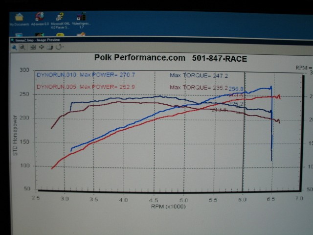

Keep us informed, I just added the Crawford V 5 Plenum along with NISMO headers and the Dyno results were fantastic. We were still gaining hp and hit the stock rev limiter, I have spoken to Doug about the newest re-flash and he seemed very optimistic, not counting the fact that I need to raise rev limiter.
Here is the dyno with addition of the Plenum and headers, it is compared to the last dyno with the mods listed on sig.

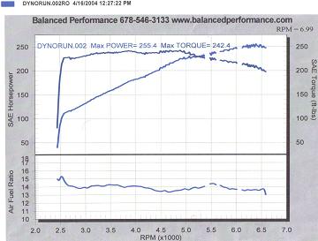

I just installed mine yesterday and was very happy with the results the extra 500 rpm makes a difference...I had the works as mine had a bad lean problem....dyno next week....
heres the dyno before the TS ecu

Also Blownaway and Duflacci let me know your A/F mix on the dyno with the TS... mine was end up on 13.2 after 6300 rpm's
