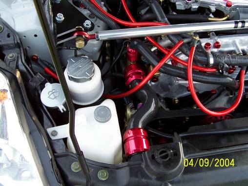

No performance or cooling benefits...........the main benefit is a great-looking, thicker-walled, long-lasting, high quality silicone hose. If you get them, you might also want to invest in some slightly larger diameter SS hose clamps since the OD of the hoses is slightly larger that the stock hoses. I did the Pi-Thon compression clamps with the Samco's & was a real BIOTCH to get the clamps over the hoses and then on the engine fittings (Pi-Thon's were designed to go on the stock hoses - took 4 hours to mount 2 of the Samco's with the Pi-Thons due to the larger OD). As I recommended on a post before, either go with the beautiful Samco hoses & SS clamps....or with the Pi-Thon fittings on the stock hoses (A little silicone spray on the stock hoses really shines them up).
Here's a small pic of the black Samco's w/Pi-Thon fitting........

thanks for the comments...kinda makes me think whether i should even do them or not...considering it took you ^ 4 hours to do 2! thats nuts...i wonder how long it would take if you had the better clamps....also what else did you have to do drain yer coolant then just start taking them off? thanks

Yes, Pi-Thon now has a listing for an increased size for their clamp on the upper radiator hose - didn't have that when I ordered the kit several months ago. Still, they need an oversized clamp for both ends of the heater hose to complete the kit for the Samco hoses. I sent them an e-mail after installing mine - hopefully, the new size for the heater hose will appear soon.
zectasy - don't freak out...it took 4 hrs. on the 2 Samco hoses WITH the Pi-Thon fittings due to wrestling with the larger OD on the hoses. If you use regular hose clamps, the Samco hoses take about 1-2 hours to install - easy stuff!
