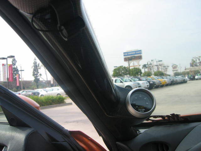

Could you guys post some pix of where our AEM A/F gauge is located. I'm curious to see what it looks like in person. With the AEM kit, do you have control over the A/F ratios meaning can you adjust if necessary? I am new to this whole thing. Any further suggestions will be greatly appreciated.
Zach
Here's a picture of Jeff@Performance's AEM A/F Gauge. His A-Pillar is CF, but you'll get the idea.
