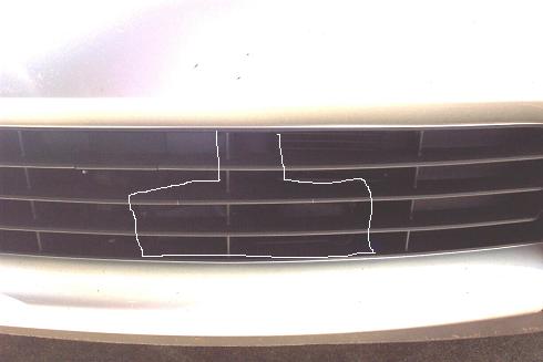

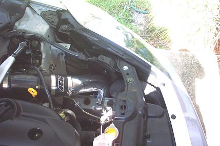

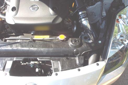

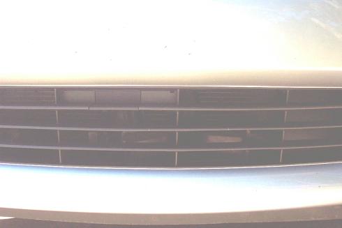

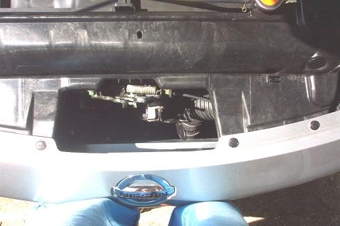

I got his idea from a buddy who has a popcharger but mine is a little different. I took the big rectangle piece from a vacuum cleaner hose and mounted it to my grill. Next i took the hose and ran it up through the stock intake whole and then ran it down to my filter. By the way i have an AEM cold air kit. Now i have a nice rush of cold air coming down to my filter. also my intake is now heat wrapped(not in pic). here are a few pics but they aren't very great.

before i installed it i tried just blowing through the length of the pipe and it was alot of air. i can't imagine the airflow at high speeds.

dude the tube is not connected to the intake. Do you think im a idiot. it just runs down towards the filter to send more air to the area of the filter. it is impossible to lose horespower. more and cooler air is getting to the filter!

i was going to but it got blocked off bya plastic divider. if i soon want to get really serious i might cut it an d make it better. i just through this together in about 15 minutes.

actually very littlke air comes from where i put the tube. most of it comes from behind the filter where the plastic underbody stops and the slits in the wheel wel. all in all i am getting more air flow no matter what you say!
