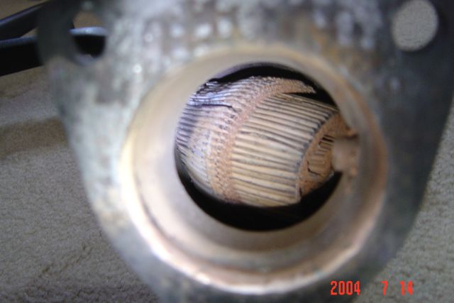

I spent about 45 minutes on the phone with Clay, they have also talked with Technosquare about this. My codes were 175 and 172 rich bank one and bank two. The straight through Stillen pipe cured that. I just got back from a long trip. One week and still no CEL's and the car runs PERFECT!
I told Clay I would start a poll about it to assist them in a possible fix for those going bad.

It seems the packing may not be in the cat tight enough and they may decide to redo this on this car only. Just count the top two cars which is 10. 7 Z's, 3 G's then look at their setups, most have headers , 3 had FI etc.
