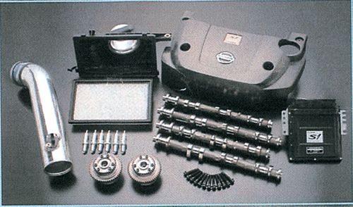

I noticed that the VTC gears are part of the s-tune package. So how much total power is gained with the S-tune package??

That total VQ35S1 (that's how they call it) engine package will bring the power up from 206KW to 221KW..... while the torque figure reminds the same but max torque happens at 4400rpm and the redline for the engine will be up to 7200rpm (with the replacement of the con rod bolts which aren't shown).... 15KW = 20.4 HP with all of those! I think Nismo might be just a bit conservative on the figure they quote though!
http://www.carnews.com.tw/1car/1car_...le_No=00000727
Laterz
Aceman
Laterz
Aceman
