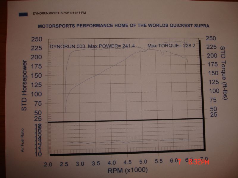

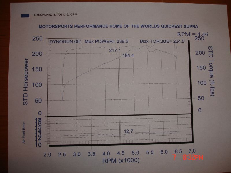

Here you guys go for the lower plenum porting. Did not do too bad.
This was on a bone stock car.
Here is the stock dyno of a 2003 350z and the dyno of the ported lower plenum.
The ECU was reset in between each pull.
Looks like we made 3hp and 4tq.
Later
Aceman
Attached Thumbnails DIY plenum porting-dyno1-stock.jpg   DIY plenum porting-dyno-2-lower-port.jpg

woa....that's awesome for the porting alone

This modification isn't just about peak HP and torque. In fact, peak numbers could be unchanged as long as more torque is created in the midrange. The MREV 2 makes as much as 12 HP at various RPM. The DIY can too.
Second point, with a DIY plenum, your cost isn't the $300+ charged by you-know-who, but maybe a hundred bucks for a used plenum and some hard work. In fact, this modification can be a no cost modification. Sell your stock plenum and completely zero out the cost.
Remember that this whole thing started because I believed that I could create my own MREV for a fraction of the cost. In December, my local speed shop will have their dyno back in operation, and I will provide "before and after" charts. Aceman's results demonstrate that this approach WORKS. Hopefully, my results will provide further evidence.

Hey bilinghm long time no see, cant wait to see your results
To the upset guy above, there is no need to be so angry. What me and Bilinghm and people like us are trying to do is give the 350z community unbiased results. Stuff like this can only benefit everyone and it gives people more ideas ( think outside the box ) we all win in the end.
It does work, and what i need to do is go back down to the shop and get them to do a overlay of stock and the ported lower plenum. I forgot to get that printed out. Im sure it makes more power in the mid range and that is what counts more than anything. Under the curve is more important than peak HP.
