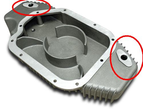

I thought the APS oil pans had NPT ports already tapped in? If you're FI'd and those ports are already taken for the oil return lines, then the APS oil pan is still compatable with an oil pan spacer.... You just won't be able to use a front lower arm bar brace is all... No biggie.

my turbo oil drain lines are already using those ports + those arent 1/8 NPT. Pan is already so low, I dont want to put a spacer in Ill just get a sandwich plate that includes the ports, I think I see one on ebay.
