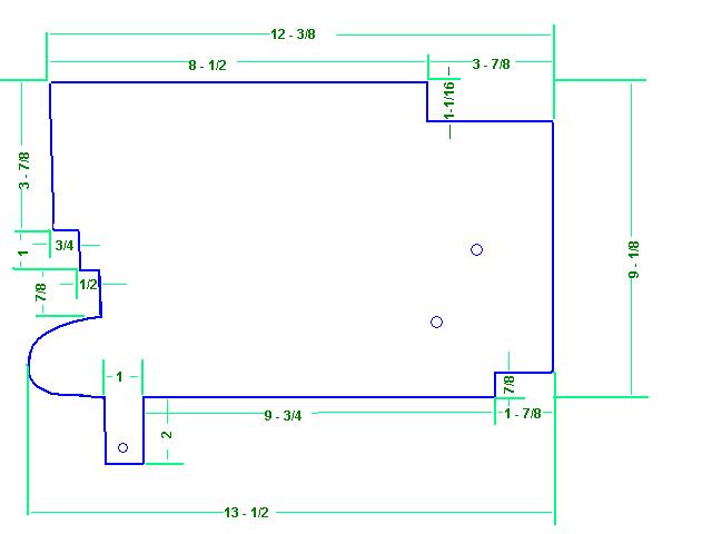

Default template dimensions
Originally posted by roark
Next, I created a template for the new ram out of heavy card stock. It took a while, pasting bits and pieces together, then transfering the final design to a clean sheet, but here's the final template.
A couple of guys asked me to post the dimensions of the template I used to create the ram. Here you go.
Attached Thumbnails Ram for AEM/Nismo CAI-ram-dimensions.jpg
