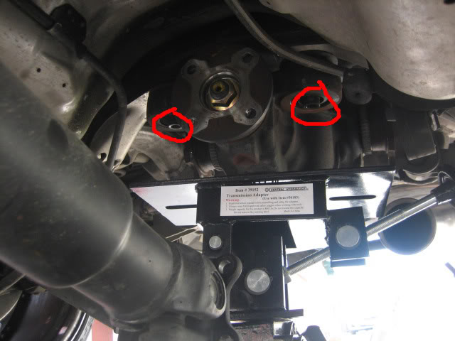

Place jack under pumpkin and remove pumpkin bushing bolts.
Im using a transmission jack adapter to make it a little easier.
I picked up this adapter @ Harbor Freight for about $40.
