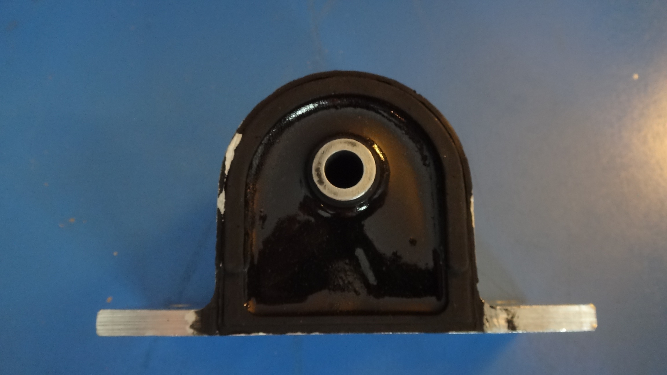

So my $0.02 on the bushing has a few other factors. The bushing was installed at the same time I had a nismo flywheel, SPL compression bushings, rest of the front end bushings, diif bushings and subframe bushings replaced with Whitelines. Here's what I noticed, the car is nice and solid now compared to before. My shifter actually seems to vibrate less, not dancing at idle or at speed. The shifter doesn't wander when going thru the gears going straight or in a turn now. Finding the gears seems easier. The overall noise and vibration is not extreme at all, rather minimal, overruled by the way it feels. Yes the overall sound has changed drawing attention to the fact this is actually a fun sporty car, not some cush car or cheap attempt at a 2door. The flywheel has its own documented NVH, but the driveline just seems natural I just hear the motor a little more now. This was just out of my first 30 miles, I can only say I wish I would have done this all sooner and can't wait to get enough coin to finish the rear suspension now

Very nicely done sir.
What durometer rubber did you use?

The kit started as an 80 durometer, I then added some Flexane which was a softening agent and brought that down to somewhere between 65-70. Im sure given time things my loosen or settle in some, but it was obvious after the mount dried how little the sleeve moved inside the mount now, even if it was just checking by hand.

Mount is holding up just fine.
Another member has sent me a used mount and urethane. I'm still digging myself out of moving but once I find all my vaccum chamber I'll knock his out as well.

Just finished up bymles 80A reinforced mount.

I'm not complaining at all about the NVH that the mount added, but it took me a little bit to get used to. It feels a lot different than having poly mounts on FWD cars I've owned. It only shakes the car at certain RPMs, but it definitely tightens things up. Based on people's complaints about the billet/full poly mounts, I highly recommend this route.
