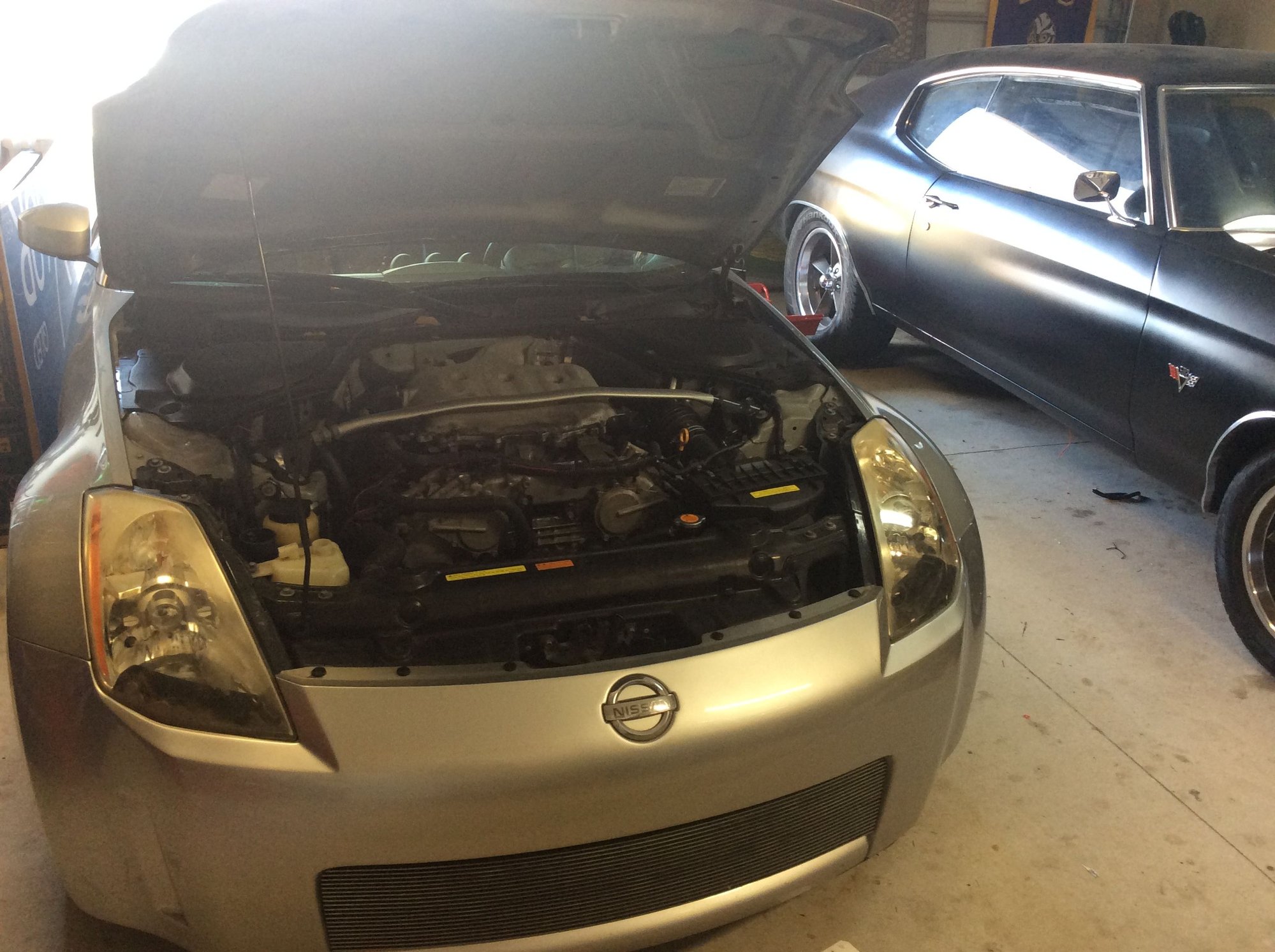

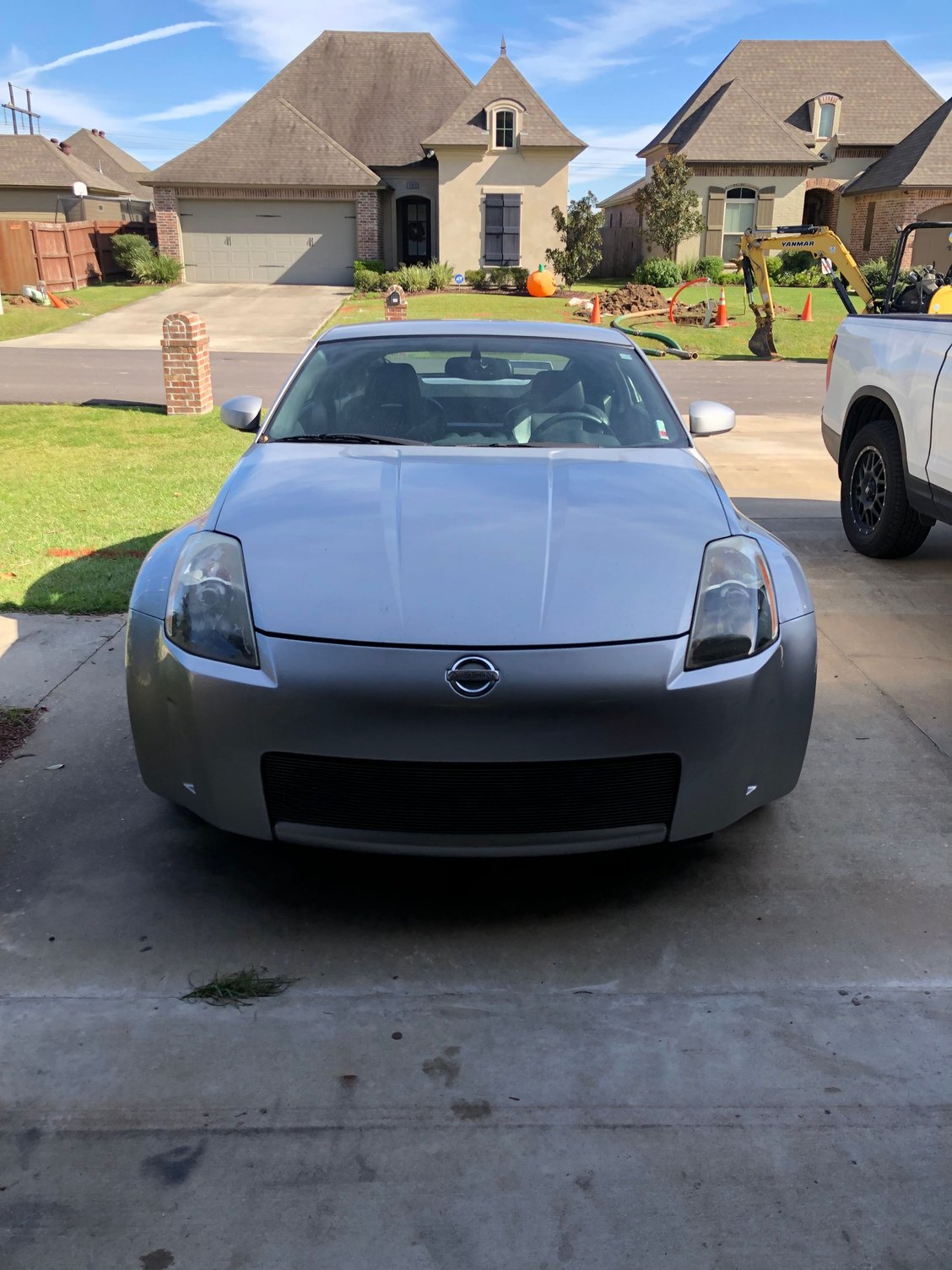

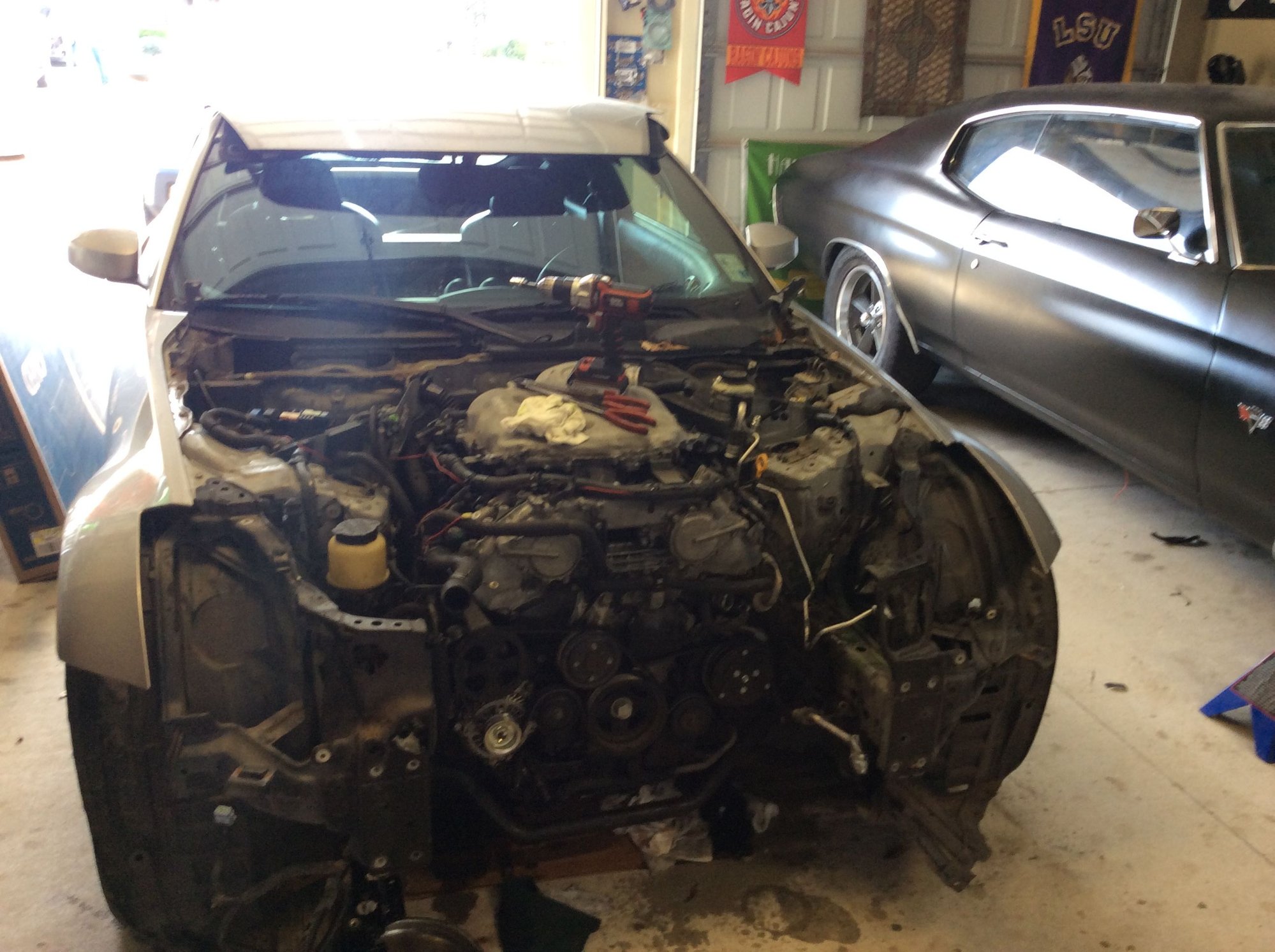

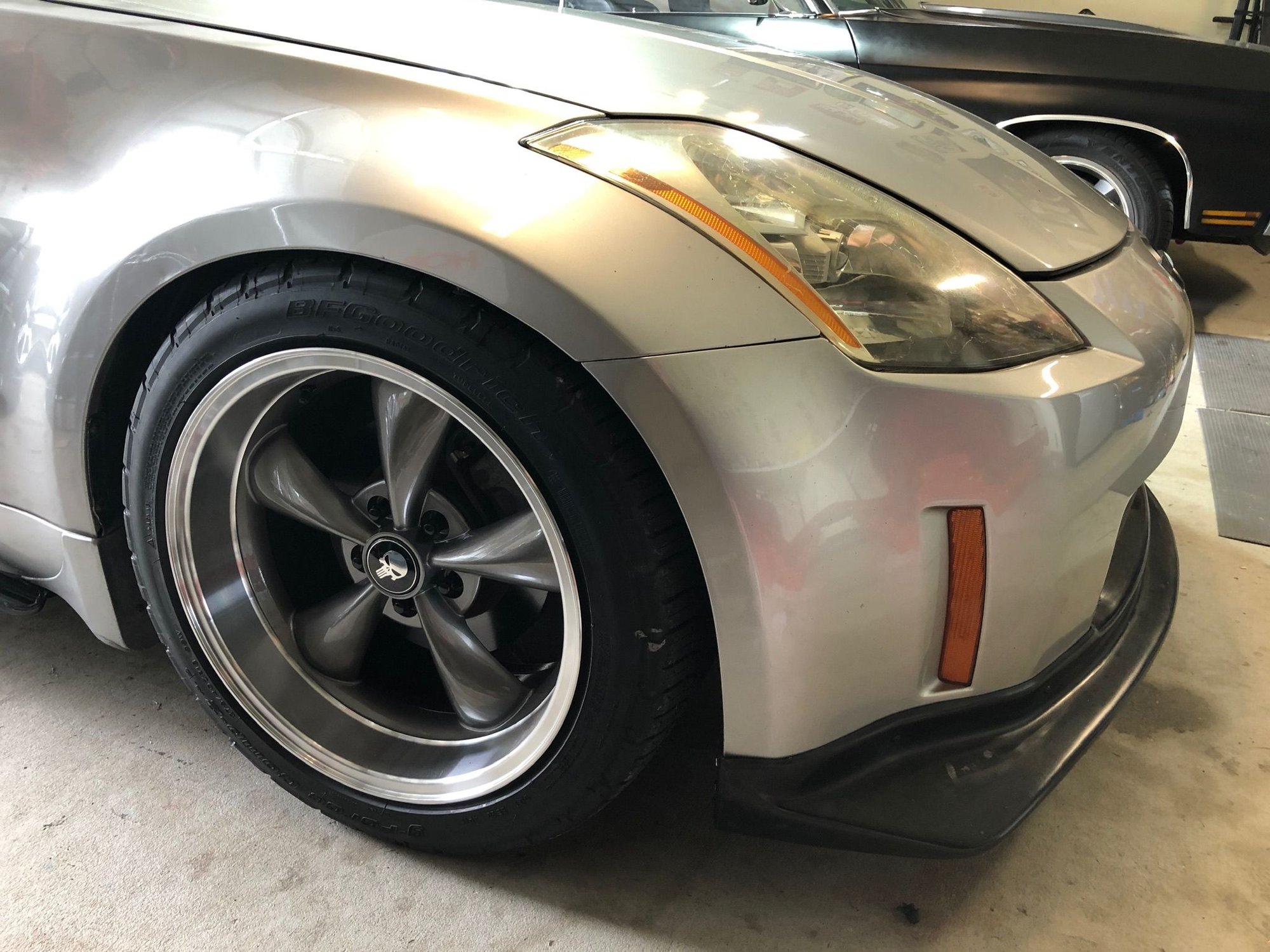

Have loved Z cars for 40+ years but never worked out where I could own one. Been an old school chevy hot rod guy my whole life. Picked up a 2003 350z, working on an LS swap. Should be fun.

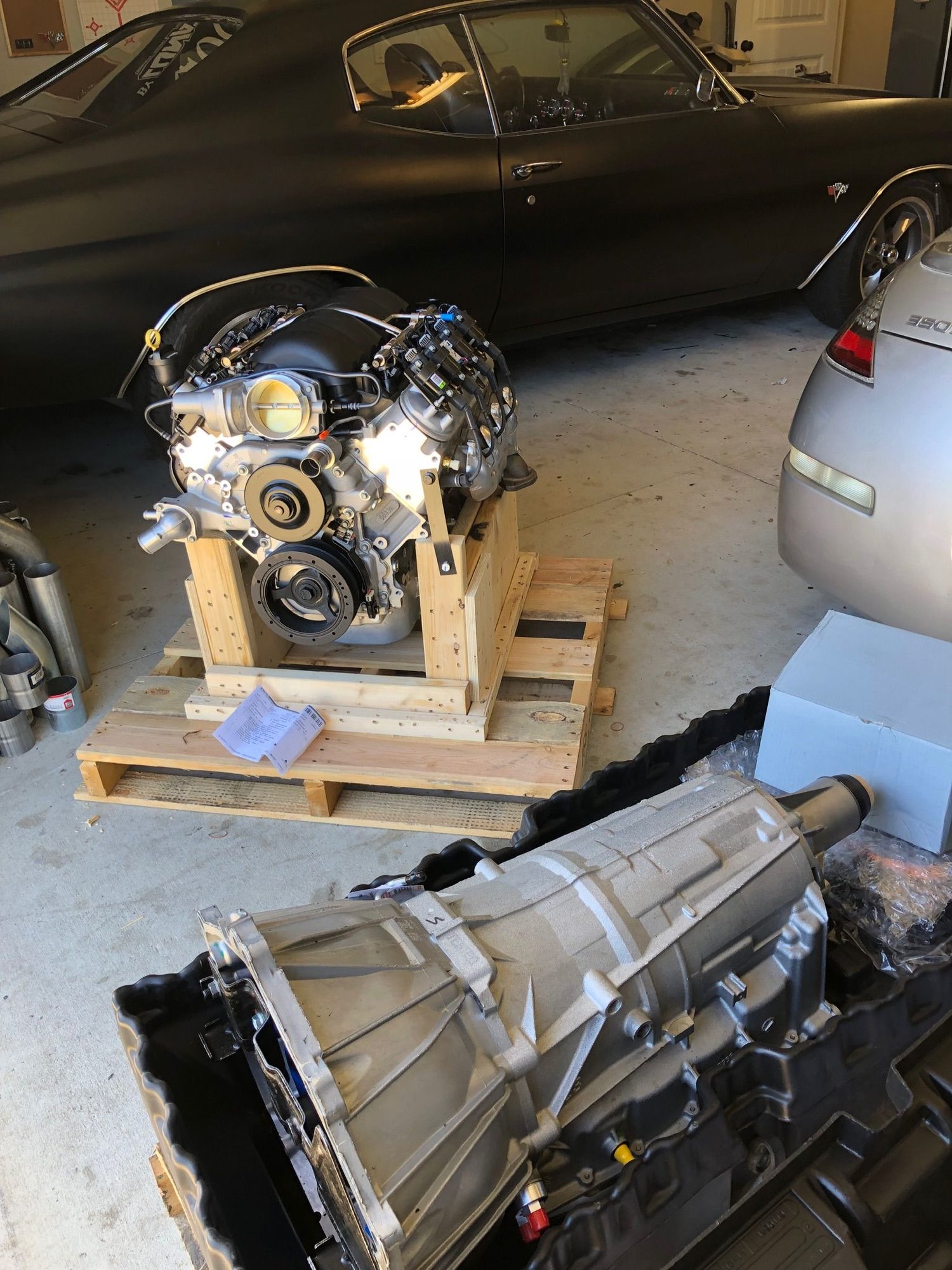

Thanks. It’s an LS3 495 Hp 6L80e paddle shifted.

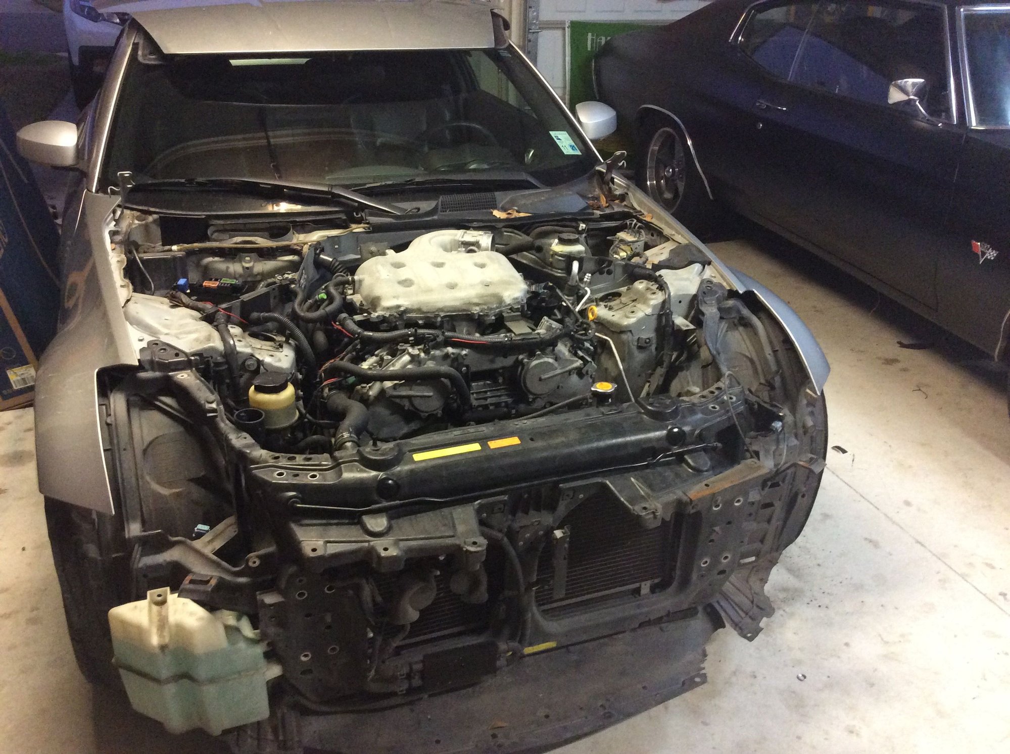

Sweet pics! Can't wait to see this build! Keep us posted.

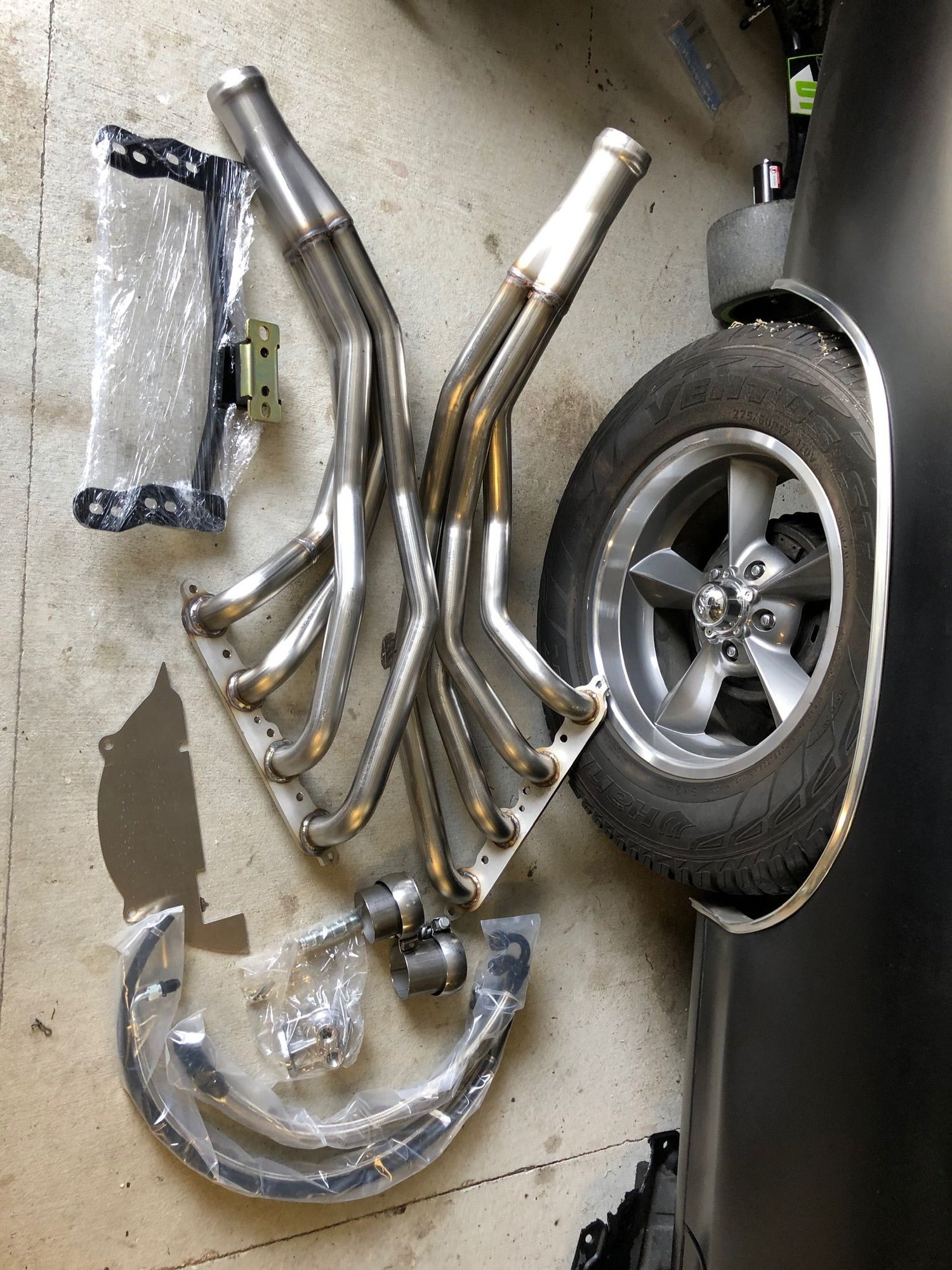

which kit are you using? are you going to keep the shorty headers or go long tube?

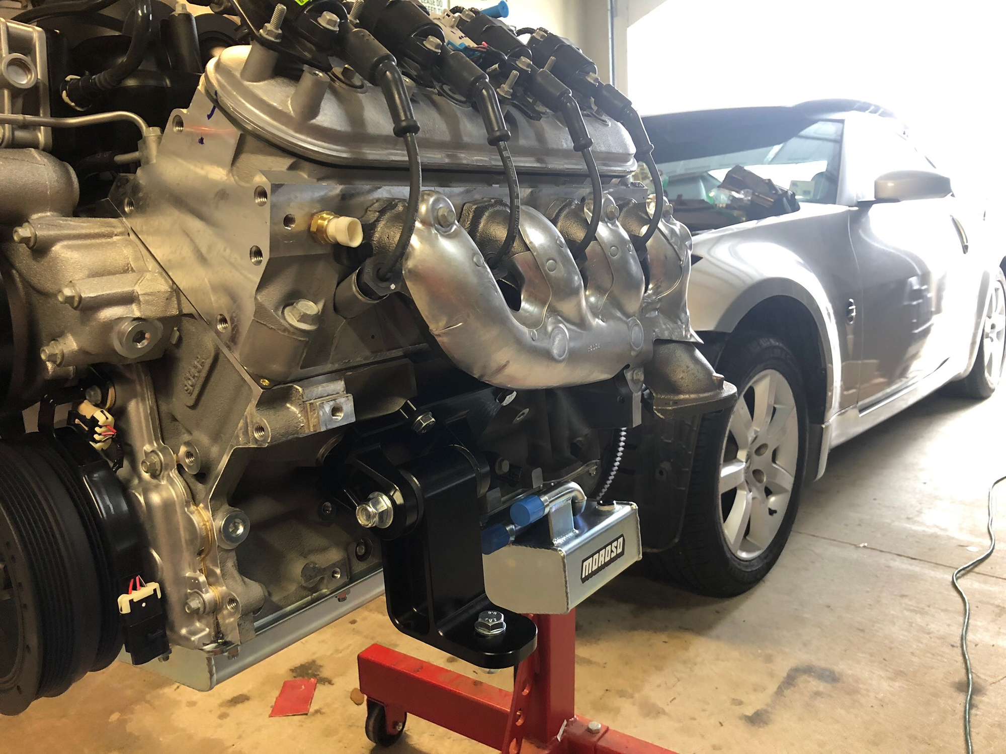

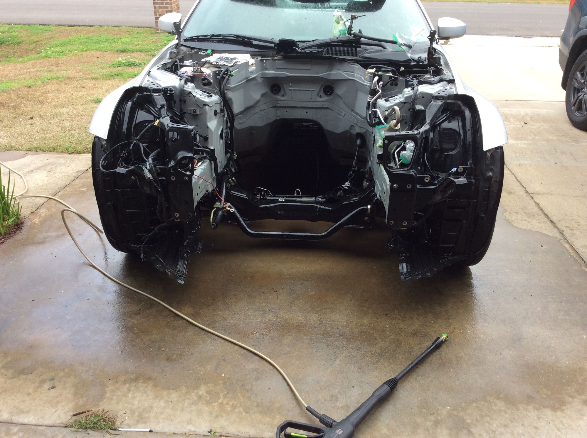

Using the fueled racing kit, complete. Long tube. Car was originally automatic. Went 6L80e w/paddle shift,(new one just released) will handle 650ft lbs tq. Will be a semi-daily driver with some 1/4 mile bracket racing .the auto will be more consistent. Have a 502/T56 super magnum in the chevelle when I want to row my own.

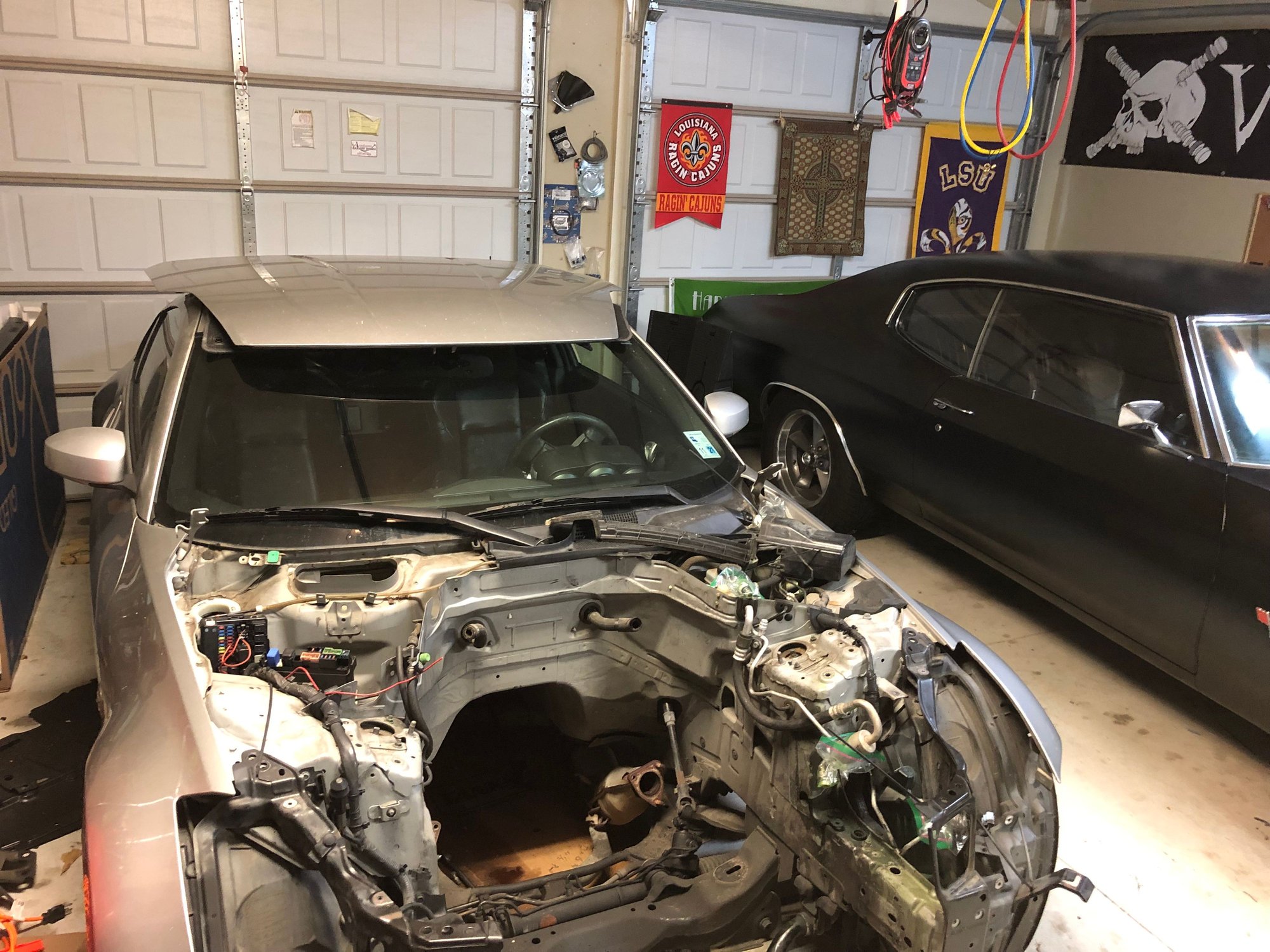

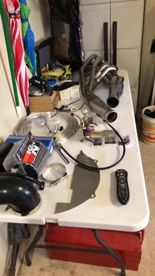

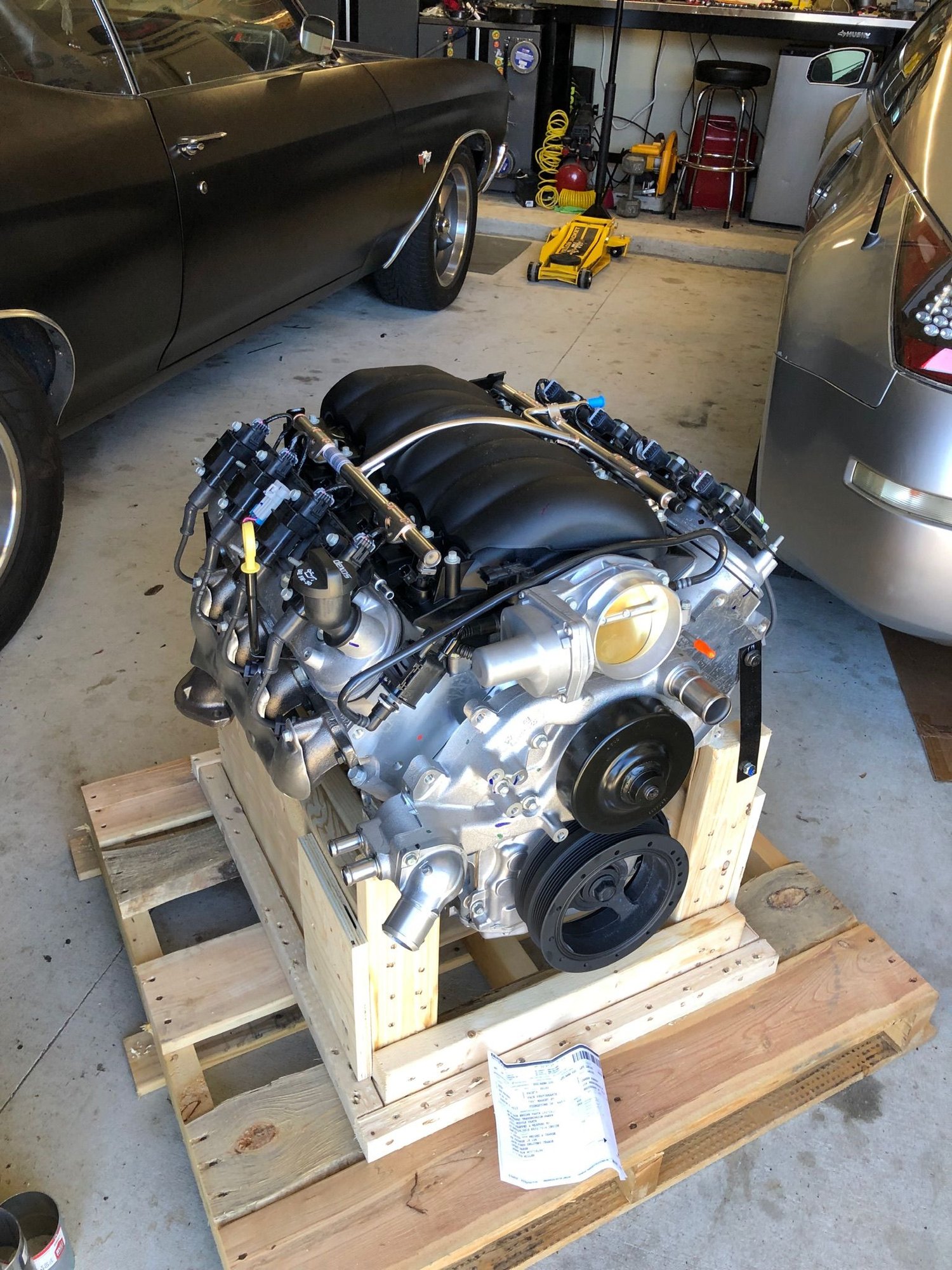

Got parts for the weekend

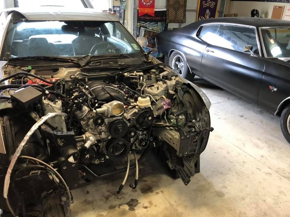

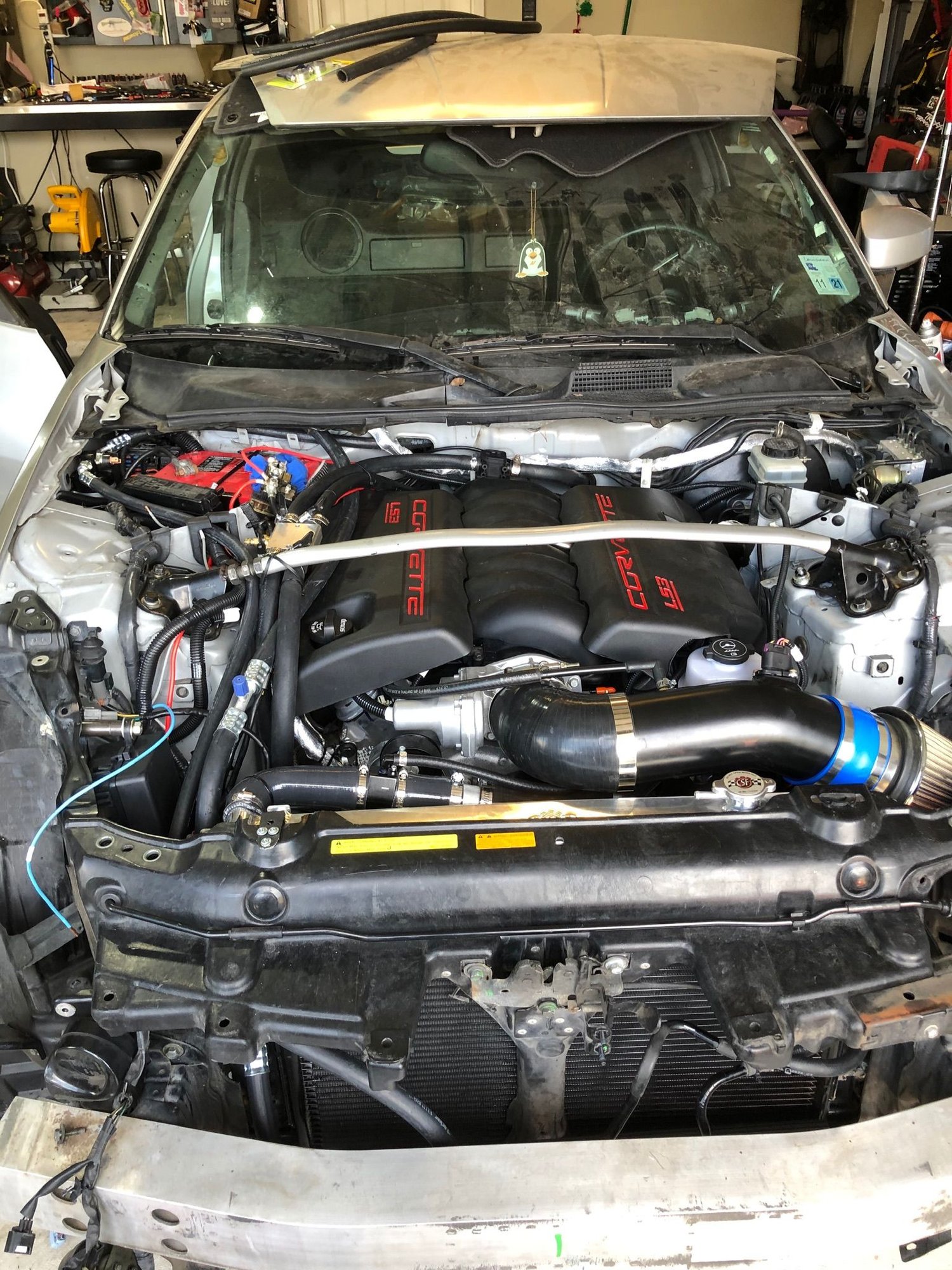

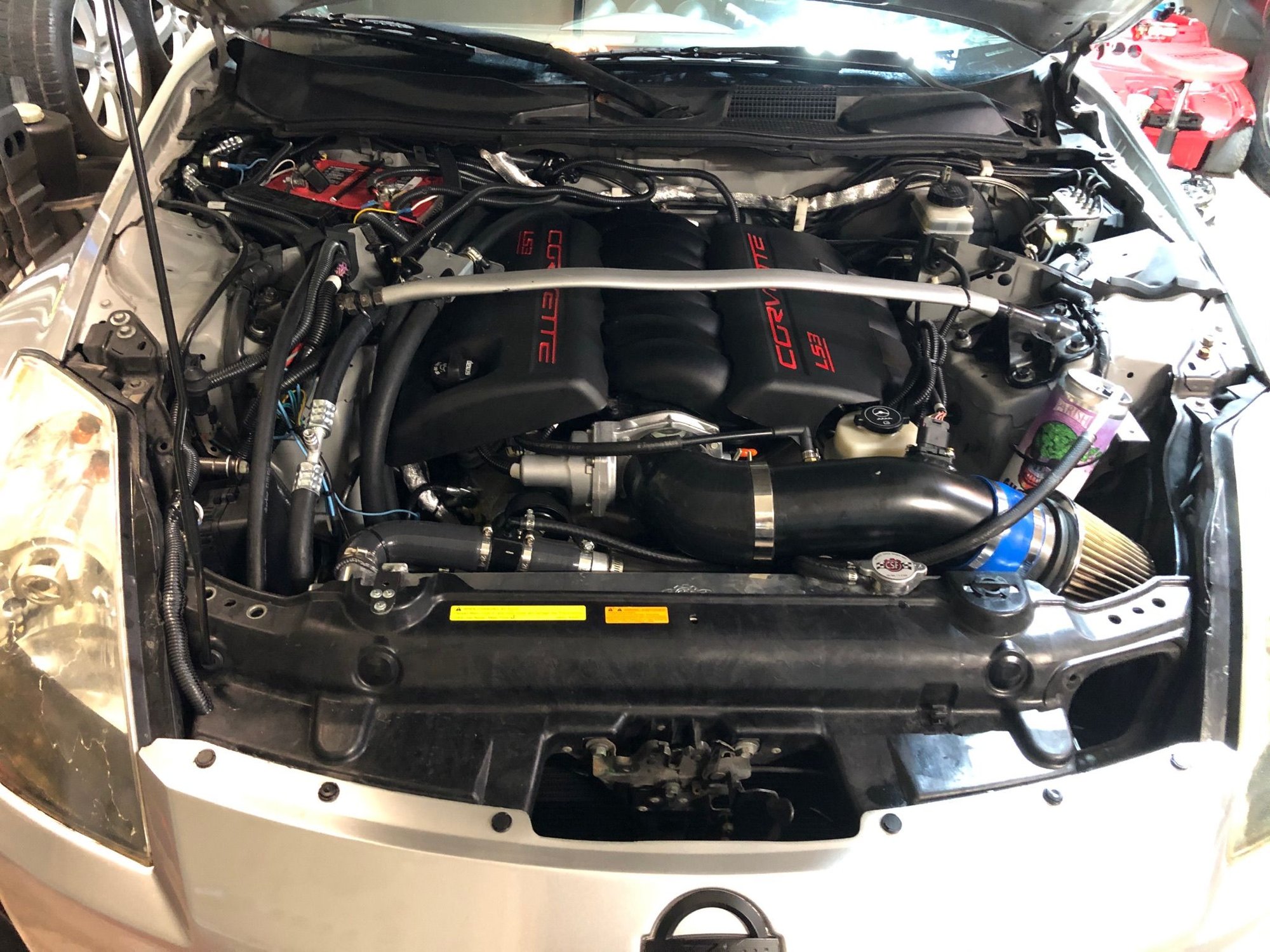

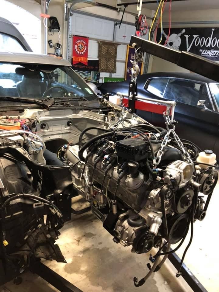

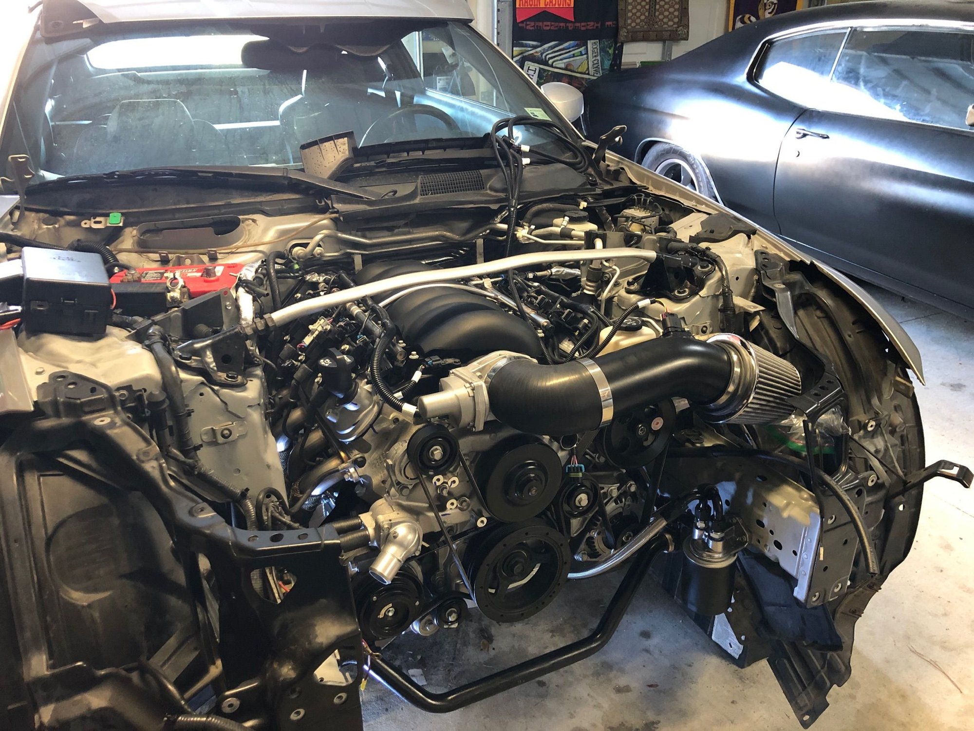

Fuel pump modded with a walbro 255, corvette filter regulator, return line, -6 stainless line. Engine and tranny built up, wiring harness installed, installed

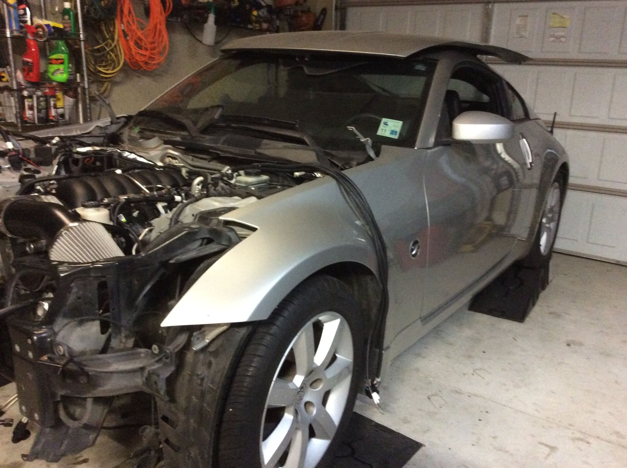

Progress, headers, remote oil filter, driveshaft, etc installed. WIRING next

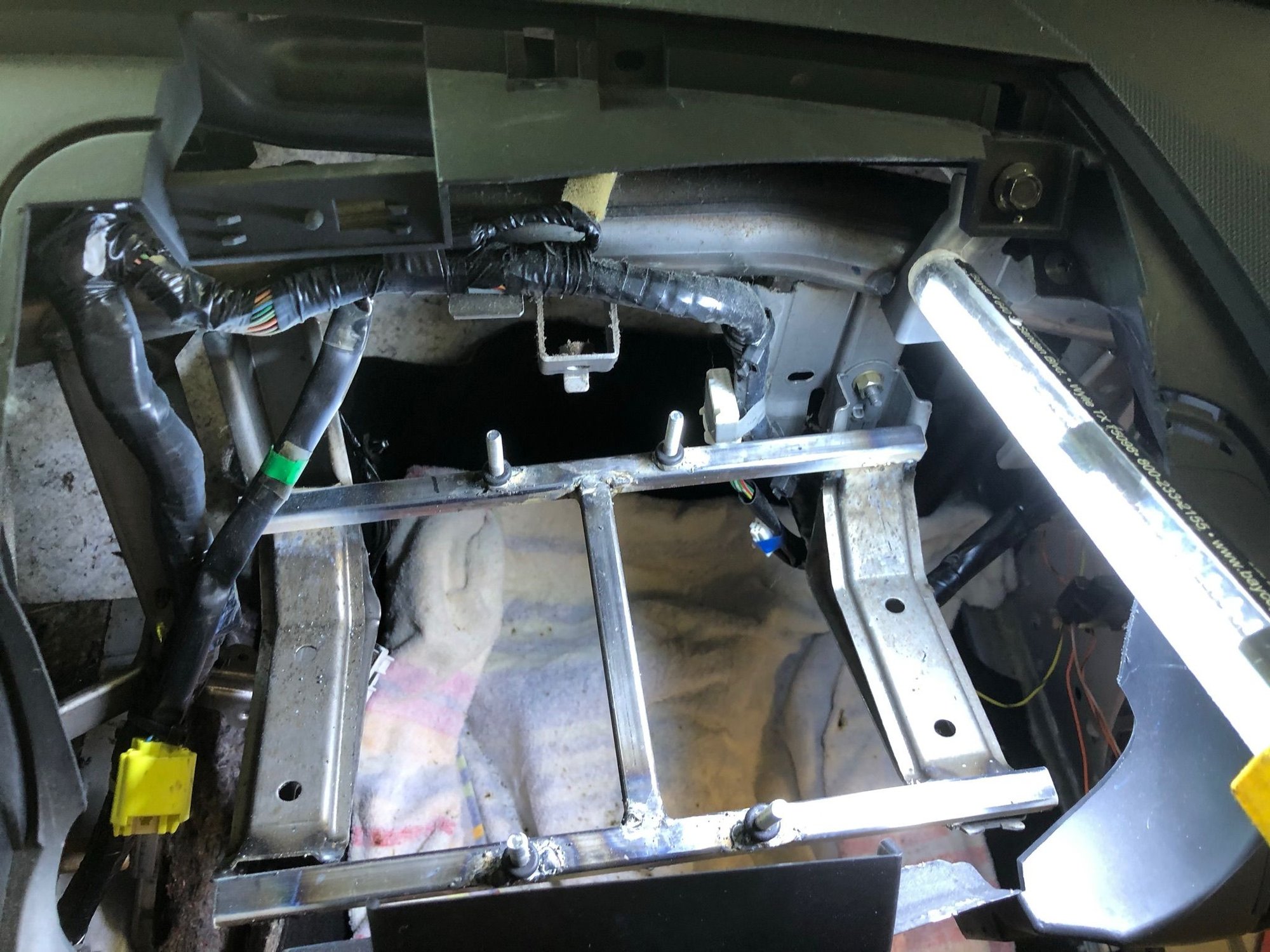

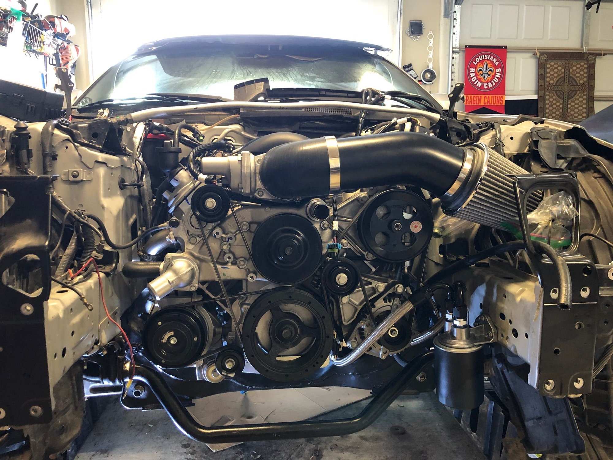

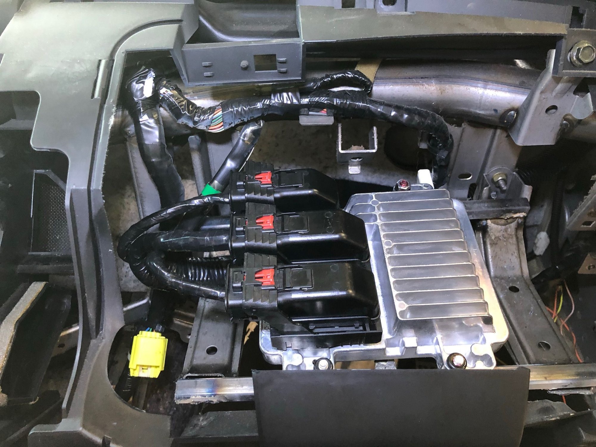

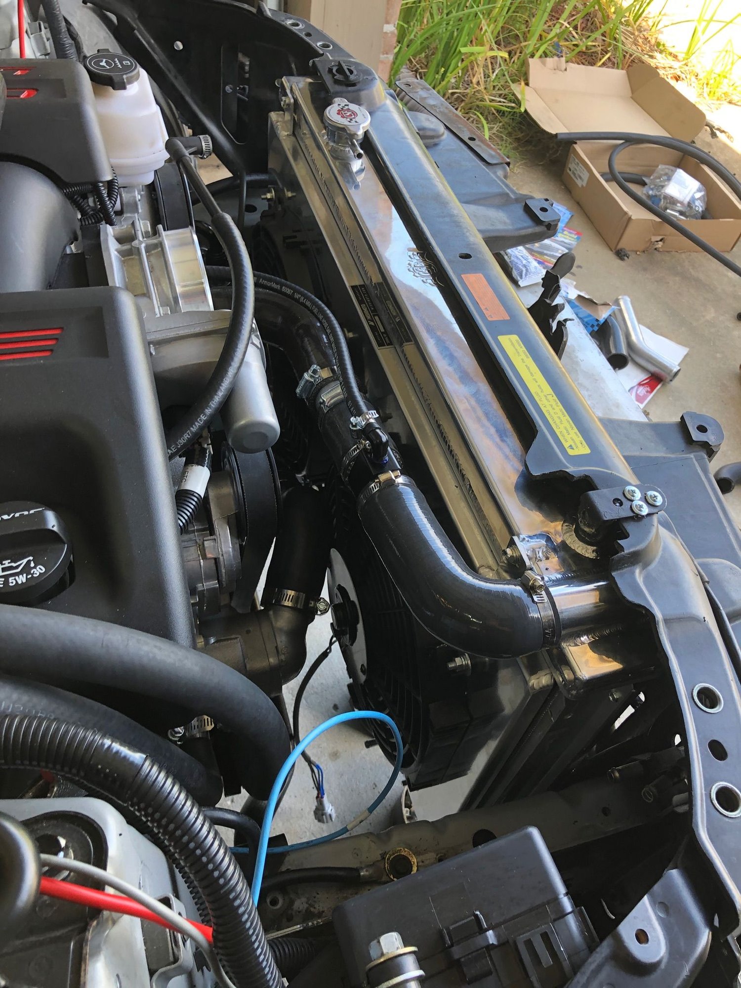

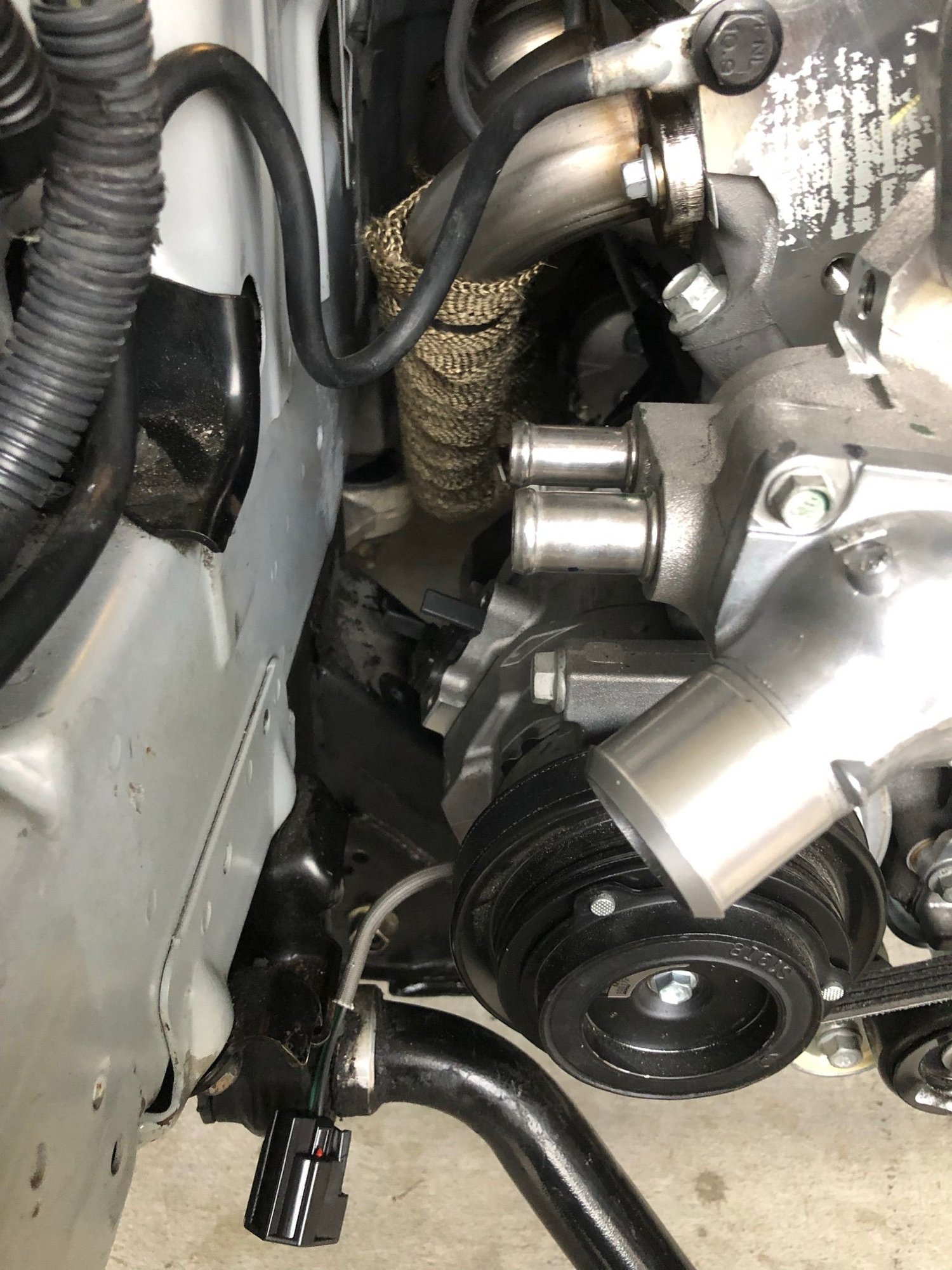

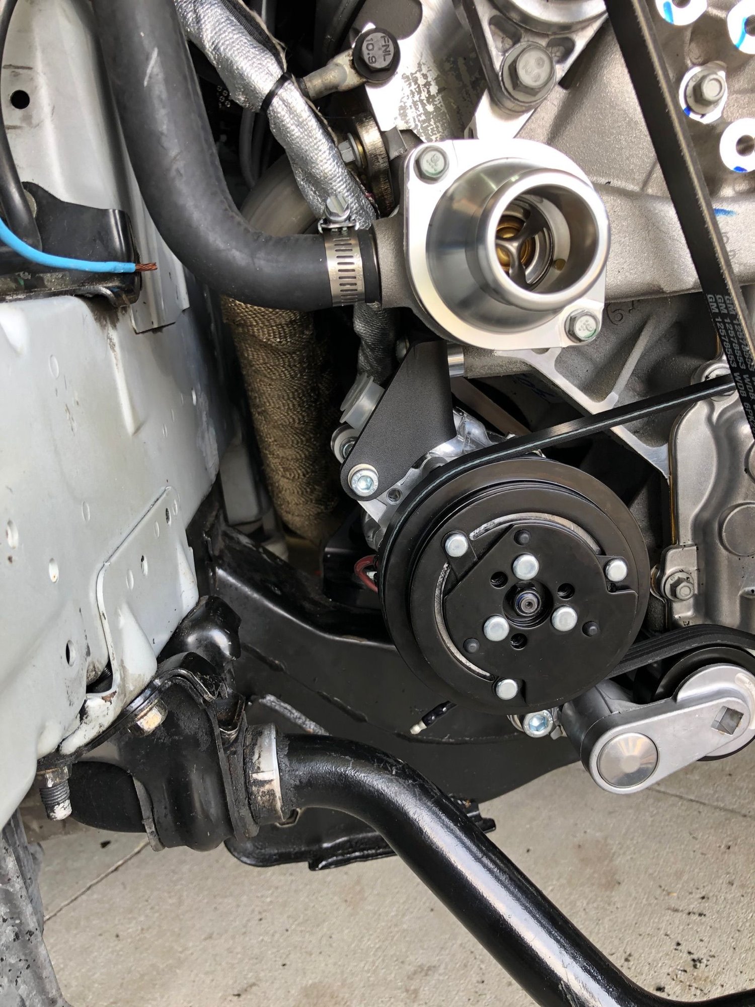

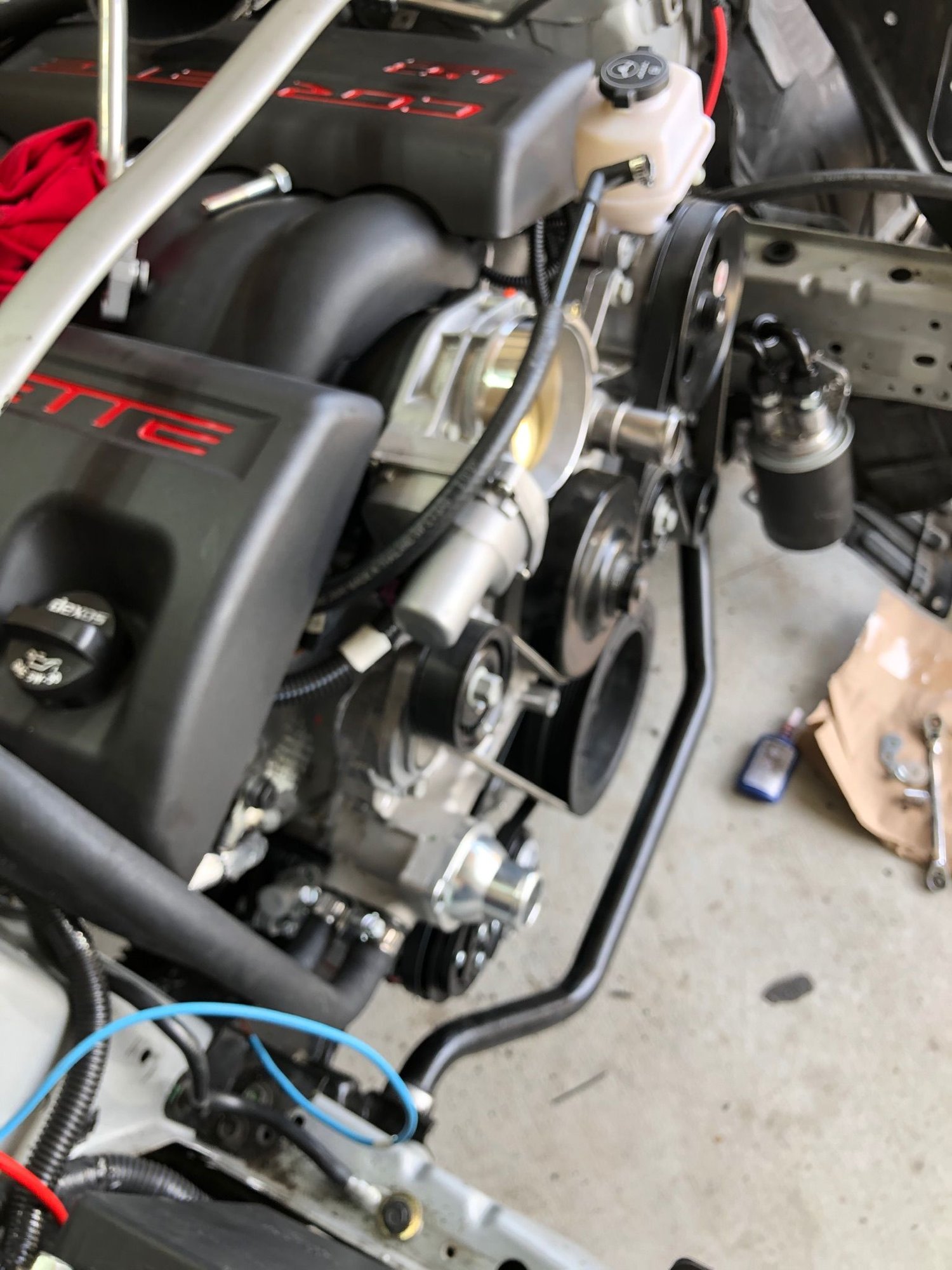

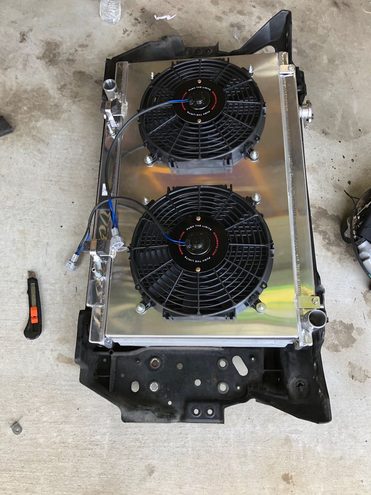

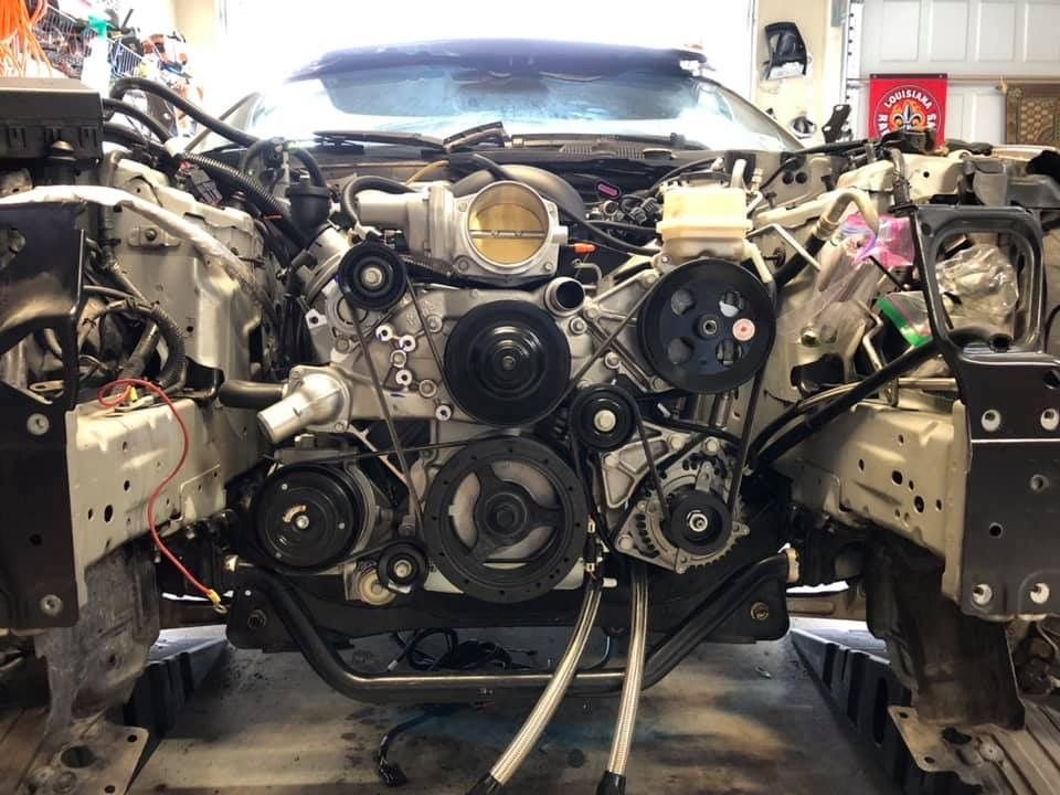

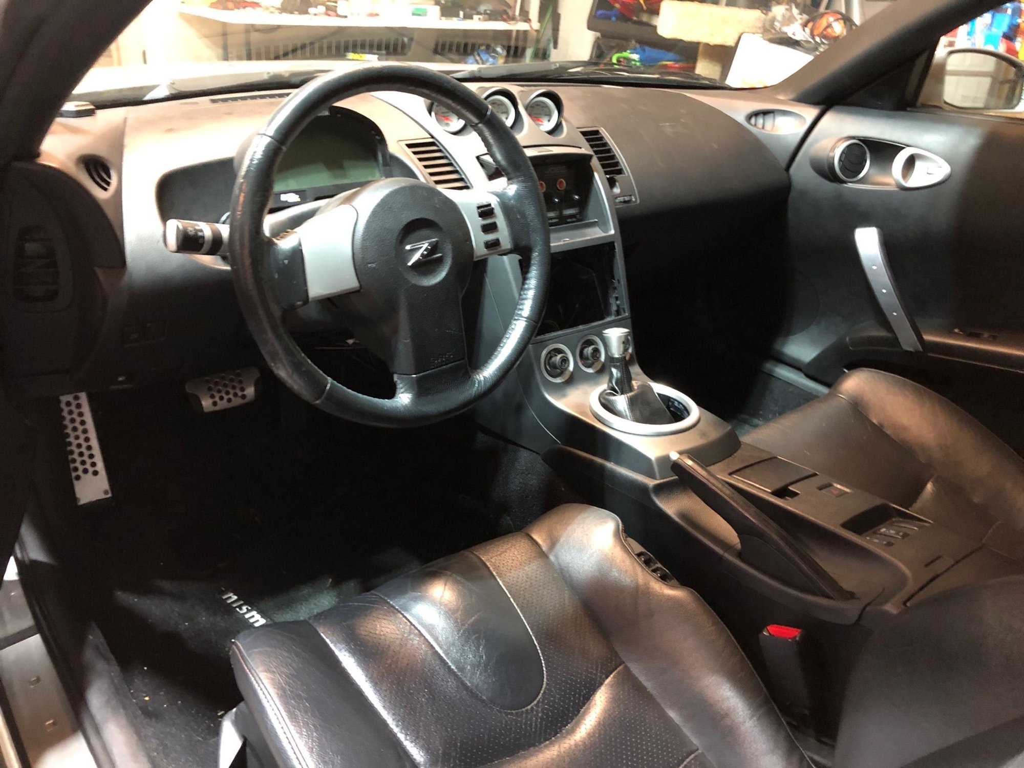

It’s been a while since I updated. BEEN a bit crazy with the covid crazyness. Still working everyday here so this is a night and maybe weekend project. D/S installed. Shifter, etc. FABBED up ECU mount where the pax airbag goes. HIt wall with the a/C system. After fighting it a while, I ripped out everything and installed a vintage air gen 4 universal system. Had to ditch the GM compressor for a dirty dingo low mount mini sanden . RAdiator and hoses mounted.MADE all A/C hoses, installed and vacuum tested. Getting closer

Very clean install! BeCool radiator? This is going to be a lot of fun.
Old Jun 14, 2020 | 02:04 PM
LSZ's Avatar
LSZ
Joined: Jan 2020
Posts: 16
Likes: 19
From: Lafayette Louisiana
CSF radiator

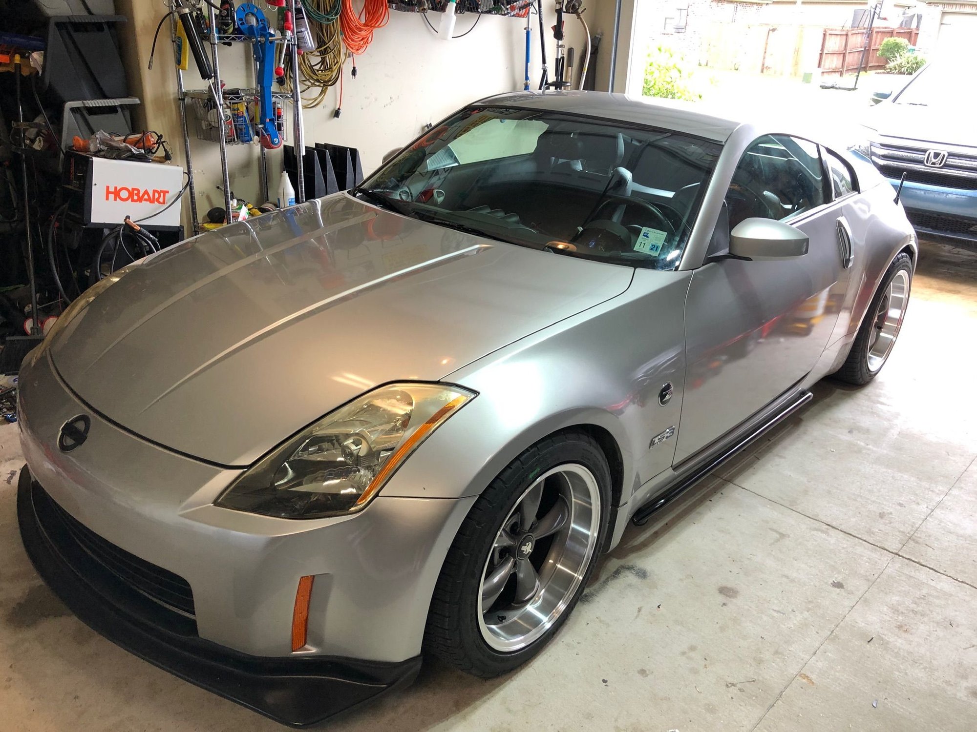

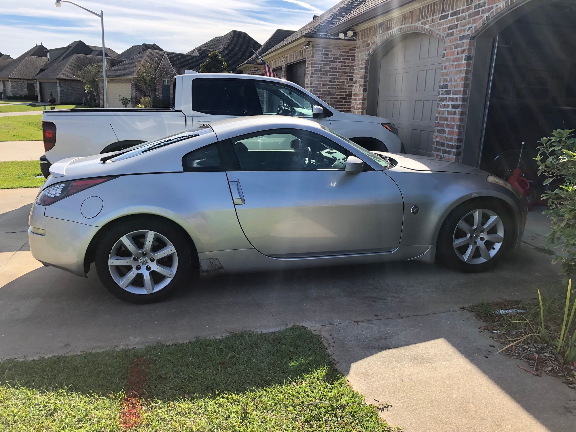

She’s done

Originally Posted by LSZ
CSF radiator
Awesome Build! Are you using a 350z style radiator or did you need to buy one that is specific to the LS engine? Ive got a 2008 350Z that i want to swap out to an LS in the future, but it needs a radiator now. So wasnt sure if i should just get something cheap to fix now or, if im able to use the same radiator in the future with the LS build, i may just go with quality like you did.
