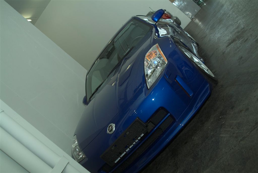

The main difference is the us-spec Nismo front is "only" a lip and the jdm front is the whole bumper (if you're looking for the front only!).
Also be advised that the us-spec is PU (which bends easily when bumped against something) and the jdm front is GFK.
Your JDM Nismo front (with jdm nismo skirts, there's also a diffference to the us-spec) shoud look like this:
hope this helps
Toni
