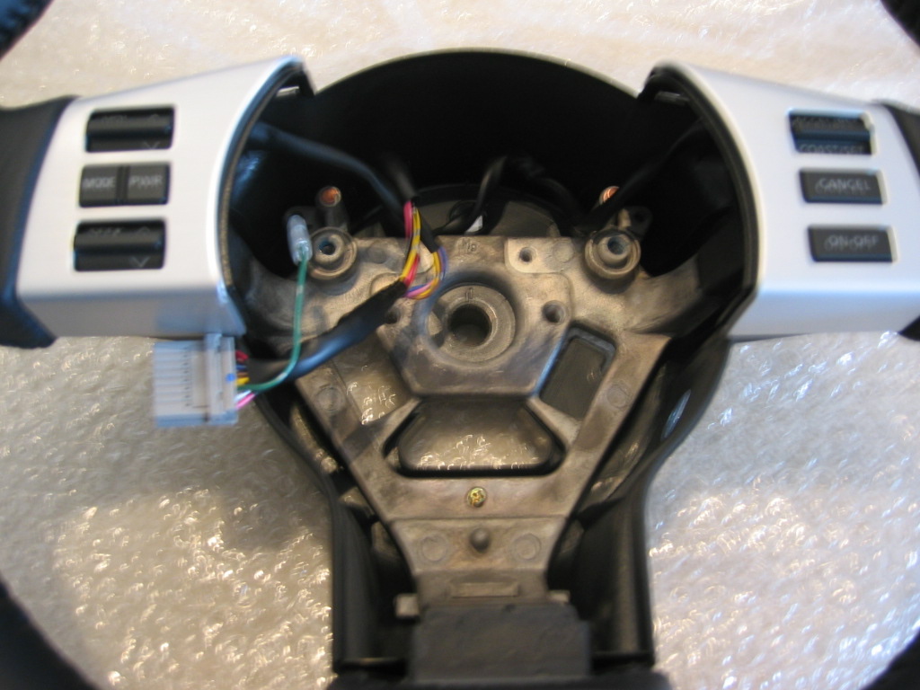

i put the 06 controls on my 05 and the cruise works but they wont light up by just simply plugging them in. There are only 3 wires on the 05 cruise control wheel, and around 8 on the 06 wheel, so there arent 8 matching wires on the steering hub harness (only 3) to give the illumination wire and radio buttons power (not that the radio buttons would work anyway)
i had my audio installer hook up a pac-swix across the radio buttons, and had him run a wire taking power from the vdc button to the steering hub harness to light up the buttons. Works fine now, but does involve some custom work
