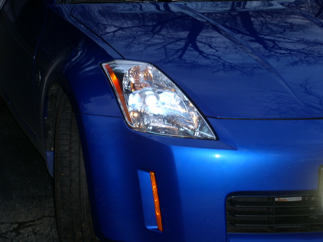

First pic, this is a little below the level of the lamps. Sorry for the grainy-ness--

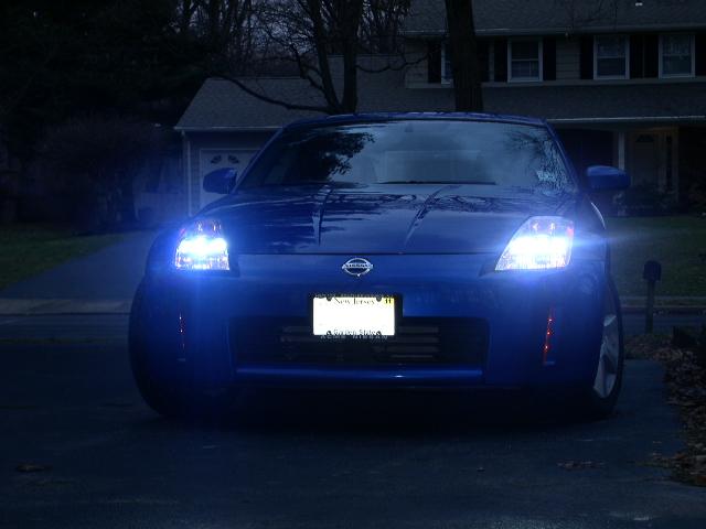

And another:

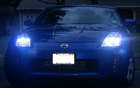

Lastly, I got the LED sidemarkers put on as well.
I'll give you guys driving impressions tommorrow since I'm driving up to New York this evening
Mr. Fairlady, I'll be taking underhood pics in a few--

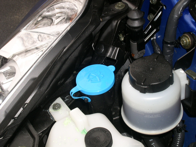

Damned if I can tell where the wires are. You'll see this underhood pic doesn't really show much. I can't even figure out which wires go to the bulbs. I think maybe they had to go through the fenderwell to access the lights. I know I used the DH7 kit for my base model. All other models have a 9006 bulb for their low beams. So the H7 should work for you if you have the base model.

Damn,...that dosen't really show how the bulbs go in through the back of the light,..but thats a clean install though!
I wouldn't think they cut that Circular piece,..maybe the ran them how the Factory comes,...I have no clue,..I'm gonna DIE!
This ***** killin me!
THANX though!I'll have to make em work I guess,.I have no idea why they didn't work but I'm screwed!
