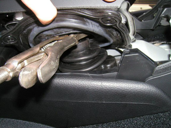

I used vise grips on the part just below the actual ****, clamped the pi$$ out of them, used counterforce and twisted the **** as hard as I could until my wrist felt like it was gonna snap and could not get it to come loose or even make cracking sounds. I imagine using a wrench (strap wrench) or something on the **** would give me more leverage but I'm not spending X amount on a Craftsmen specialty wrench that I'm only gonna use once.

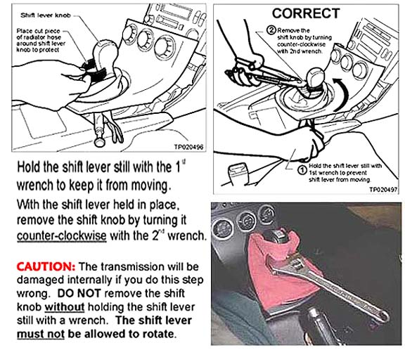

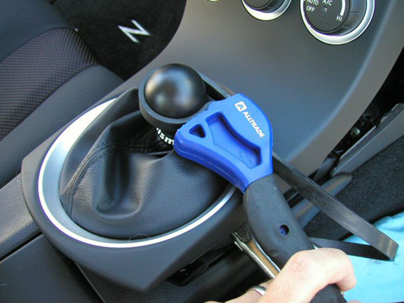

imprettysure what you did was hold the chrom part of the **** thinking it wasnt attached.... if you did this your wrong the whole thing is one piece. and you have to viese onto the rubber coupler on the bottom shaft
woo hoo I got it off.
I forgot I had a big *** crescent wrench, so I tried that and a towel on the **** and it came off.
Didn't even mess up the stock ****.

For some reason, a number of 350Z owners have reported that their gear shift ***** have been more difficult to remove than others. As long as you can firmly secure the shaft, the shift **** can be removed by applying a little extra (elbow grease) torque.
